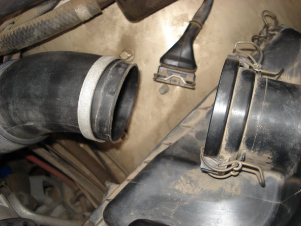

  2. 1985-1988 Volvo 740 Mass Air Flow (MAF) Sensor Maintenance, 1985-1988 Volvo 740 Mass Air Flow (MAF) Sensor Maintenance: step 2, image 1 of 2 1985-1988 Volvo 740 Mass Air Flow (MAF) Sensor Maintenance, 1985-1988 Volvo 740 Mass Air Flow (MAF) Sensor Maintenance: step 2, image 2 of 2
    • Unlatch the two clasps, as outlined in the image.
    • Loosen the screw on the metal band, using a flathead screwdriver.
  3. 1985-1988 Volvo 740 Mass Air Flow (MAF) Sensor Maintenance: step 3, image 1 of 2 1985-1988 Volvo 740 Mass Air Flow (MAF) Sensor Maintenance: step 3, image 2 of 2
    • Disconnect the electronic sensor from the MAF.
    • Press on the 2 latches, pulling the cable away from the sensor.
  4. 1985-1988 Volvo 740 Mass Air Flow (MAF) Sensor Maintenance: step 4, image 1 of 2 1985-1988 Volvo 740 Mass Air Flow (MAF) Sensor Maintenance: step 4, image 2 of 2
    • Disconnect the rubber hose from the MAF.
    • Remove the MAF from the air filter housing.
