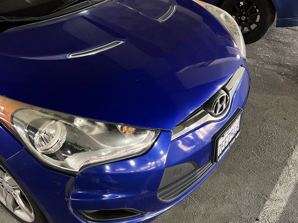

  3. 2014 Hyundai Veloster Headlight Replacement: step 3, image 1 of 2 2014 Hyundai Veloster Headlight Replacement: step 3, image 2 of 2
    • Your headlights are located on the left and right sides of the front of your vehicle and are covered by a cap.

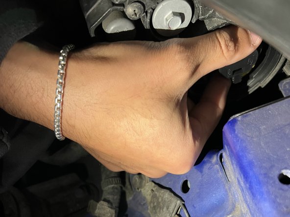

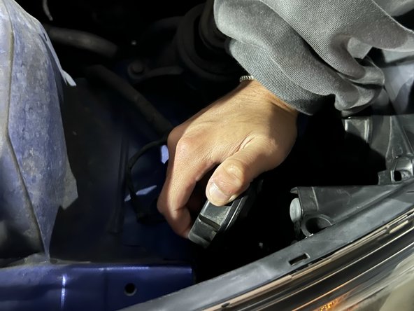

  4. 2014 Hyundai Veloster Headlight Replacement: step 4, image 1 of 3 2014 Hyundai Veloster Headlight Replacement: step 4, image 2 of 3 2014 Hyundai Veloster Headlight Replacement: step 4, image 3 of 3
    • Twist the cap to the left and pull it off.
    • Twist the headlight to the left and pull it out too.

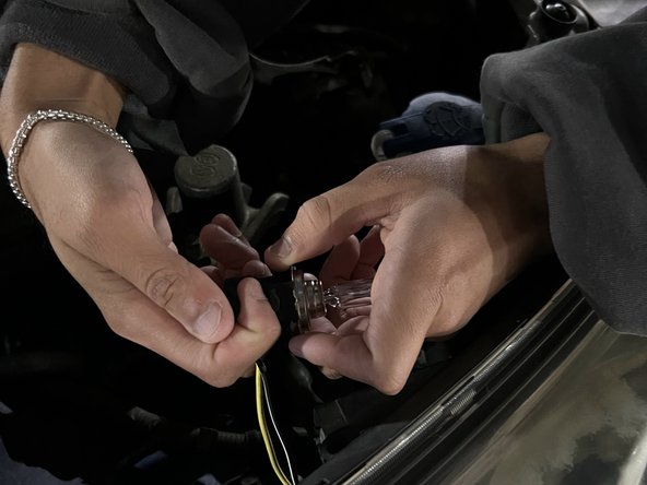

  5. 2014 Hyundai Veloster Headlight Replacement: step 5, image 1 of 3 2014 Hyundai Veloster Headlight Replacement: step 5, image 2 of 3 2014 Hyundai Veloster Headlight Replacement: step 5, image 3 of 3
    • Pull the headlight bulb out of the socket.

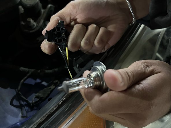

  6. 2014 Hyundai Veloster Headlight Replacement: step 6, image 1 of 3 2014 Hyundai Veloster Headlight Replacement: step 6, image 2 of 3 2014 Hyundai Veloster Headlight Replacement: step 6, image 3 of 3
    • Plug the new headlight into the socket and place it back into its space.
    • Don't touch the bulb glass with your fingers because the oil from your hands will cause the glass to degrade and wear faster or shatter.
    • Lock it into place by twisting it slightly to the right.
    • Put the cap back on and twist it slightly to the right to lock it in place.
