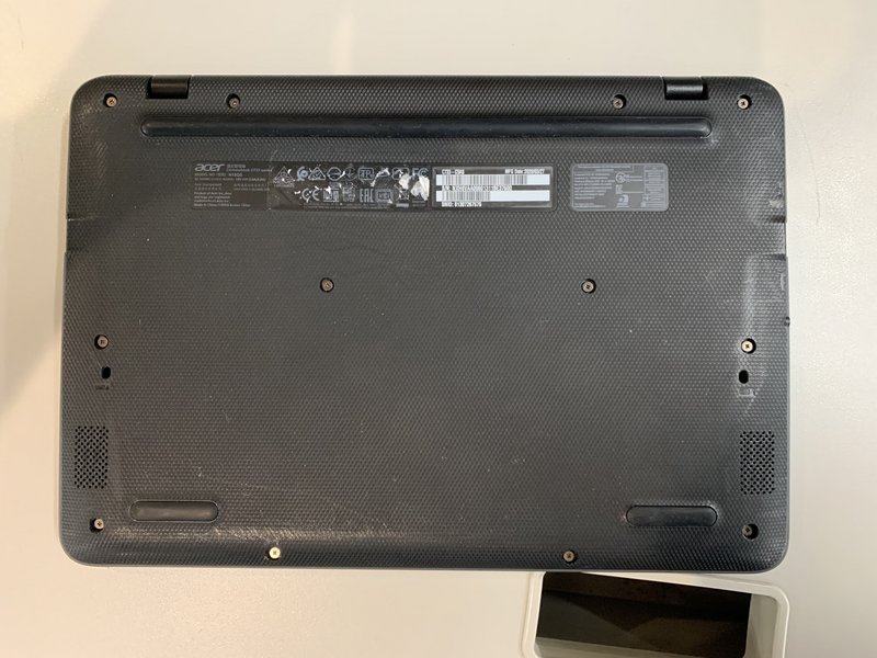

    • Flip the computer over, and using a Phillips #1 screwdriver, remove all 12 bottom cover screws.
    • Once all the screws are removed, place both pointer fingers between the screen hinges and the case and carefully pry the case away from the hinges.
