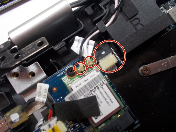

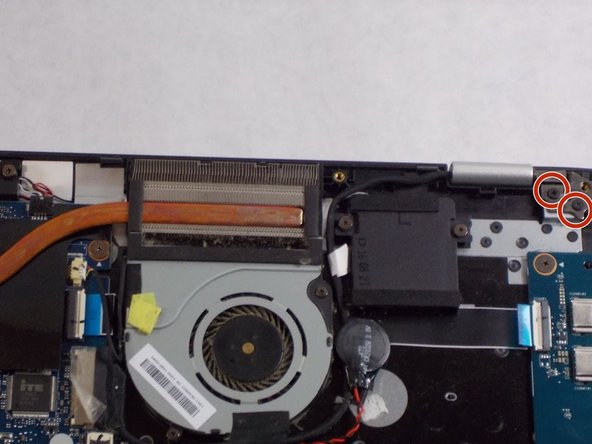

    • Using the Phillips #1 screwdriver, remove a total of four screws from the hinges (two on each hinge).
  4. Acer Spin 3 SP315-51-79NT Screen Assembly Replacement: step 4, image 1 of 2 Acer Spin 3 SP315-51-79NT Screen Assembly Replacement: step 4, image 2 of 2
    • Remove wires connecting to motherboard.
    • You can then simply pull the two halves of the computer away from each other.
