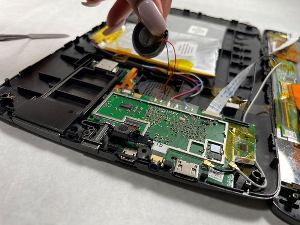

  6. Archos 101 G9 Speaker Replacement, Speaker: step 6, image 1 of 2 Archos 101 G9 Speaker Replacement, Speaker: step 6, image 2 of 2
    • Pry the speaker free from the case using a nylon spudger.
  7. Archos 101 G9 Speaker Replacement: step 7, image 1 of 1
    • Remove the tape covering the connections on the motherboard.
  8. Archos 101 G9 Speaker Replacement: step 8, image 1 of 1
    • Desolder the HP+ connection on the motherboard.
    • Desolder the HP- connection on the motherboard.
    • Be cautious when using the soldering iron.
    • Remove the speaker from the tablet.
