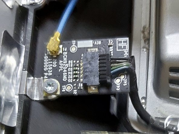

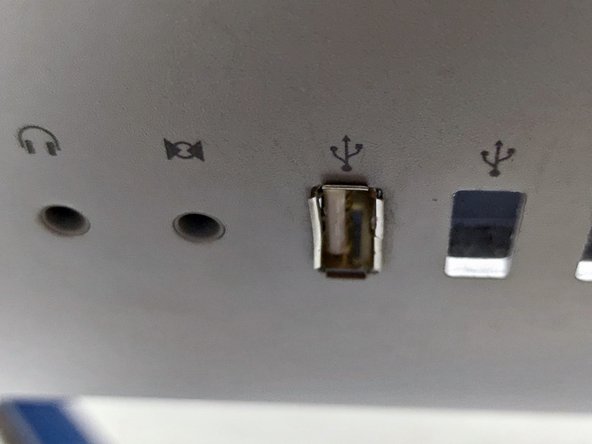

  3. Converting iMac Intel 27" to an USB-C monitor with 30W charging, Hook up internal USB devices: step 4, image 1 of 3 Converting iMac Intel 27" to an USB-C monitor with 30W charging, Hook up internal USB devices: step 4, image 2 of 3 Converting iMac Intel 27" to an USB-C monitor with 30W charging, Hook up internal USB devices: step 4, image 3 of 3
    • Disassemble USB Man-style hub, cut cables, insert USB sockets into usb openings, hot glue USB ports from the inside and solder everything back together
    • Something like this... https://www.amazon.com/Kikkerland-US006-...
    • you need another 5v/12v powered 4 port hub to connect the iSight, SuperDrive, SD Card Reader and the rear ports. And some donor USB cables...
    • iSight Pinout +5v = brown, D+ = Purple, D-= grey GND=black. Unfortunately Apple uses different colors for different revisions. Pinout of the iMac's built in iSight..
    • SD Card Reader Pinout +5v = orange, D+ = grey, D-= purple, GND=unshielded cable. Again, Apple uses different colors for different revisions, although you'd think the cabling color scheme would be at least internally consistent.... https://www.tonymacx86.com/threads/apple...
    • Connect the USB-SATA bridge to the SuperDrive and the USB hub. I had to cut away some plastic to fit the USB adapter
    • Power the USB hubs with the 12v pins, or use a DC-to-DC stepdown board to convert 12v to 5v. (The power supply doesn't provide a 5v rail...)
