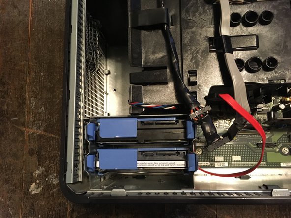

  4. Dell Optiplex GX620 Front panel Replacement, Unplug your hard drive.: step 4, image 1 of 3 Dell Optiplex GX620 Front panel Replacement, Unplug your hard drive.: step 4, image 2 of 3 Dell Optiplex GX620 Front panel Replacement, Unplug your hard drive.: step 4, image 3 of 3
    • Remove the SATA power and data cables.
    • SATA Power
    • SATA Data
  5. Dell Optiplex GX620 Front panel Replacement, Unplug your floppy drive.: step 5, image 1 of 3 Dell Optiplex GX620 Front panel Replacement, Unplug your floppy drive.: step 5, image 2 of 3 Dell Optiplex GX620 Front panel Replacement, Unplug your floppy drive.: step 5, image 3 of 3
    • Unplug the power and data cables.

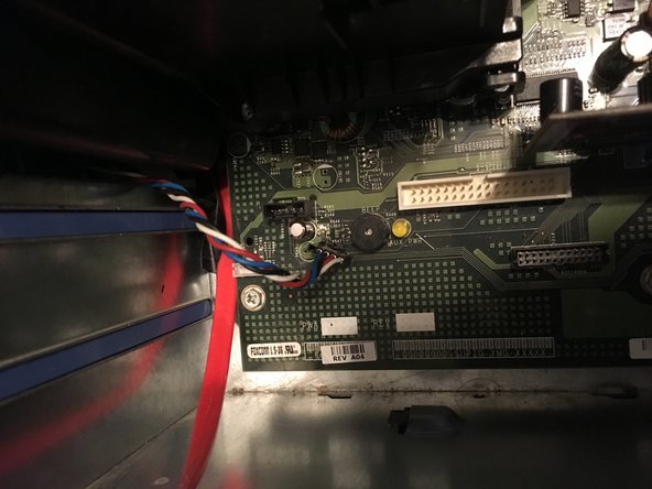

  6. Dell Optiplex GX620 Front panel Replacement, Unplug the fan.: step 6, image 1 of 2 Dell Optiplex GX620 Front panel Replacement, Unplug the fan.: step 6, image 2 of 2
    • Unplug the fan.

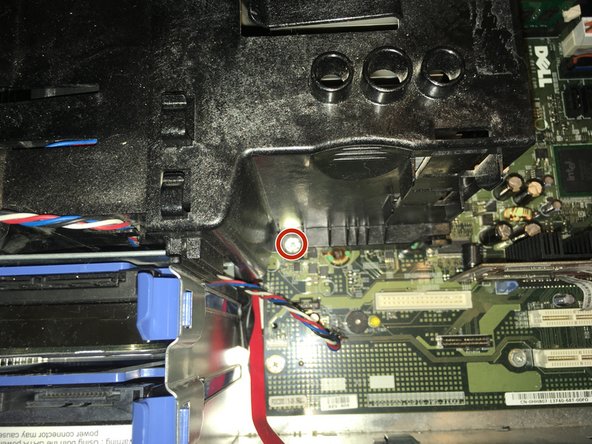

  7. Dell Optiplex GX620 Front panel Replacement: step 7, image 1 of 2 Dell Optiplex GX620 Front panel Replacement: step 7, image 2 of 2
    • Remove the two Phillips #2 screws.

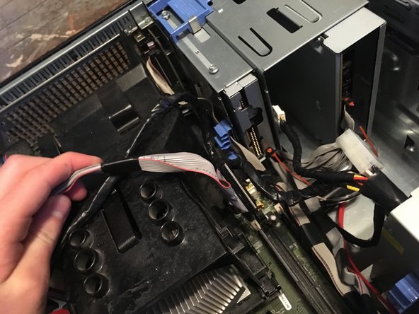

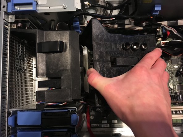

  8. Dell Optiplex GX620 Front panel Replacement, Remove the heat sink.: step 8, image 1 of 3 Dell Optiplex GX620 Front panel Replacement, Remove the heat sink.: step 8, image 2 of 3 Dell Optiplex GX620 Front panel Replacement, Remove the heat sink.: step 8, image 3 of 3
    • Pull the heat sink up.
  9. Dell Optiplex GX620 Front panel Replacement: step 9, image 1 of 3 Dell Optiplex GX620 Front panel Replacement: step 9, image 2 of 3 Dell Optiplex GX620 Front panel Replacement: step 9, image 3 of 3
    • Pull the two tabs and pull it out.
    • This needs a lot of force to take it off.

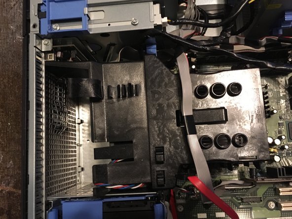

  10. Dell Optiplex GX620 Front panel Replacement, Remove front panel: step 10, image 1 of 2 Dell Optiplex GX620 Front panel Replacement, Remove front panel: step 10, image 2 of 2
    • Remove the one Phillips #2.
    • Remove the Data cable.
    • Taking this cable off will brake some of the plastic thats locking it in. But you can still plug the cable back in.

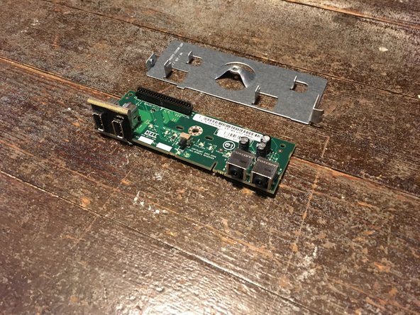

  11. Dell Optiplex GX620 Front panel Replacement, Remove the last screw.: step 11, image 1 of 2 Dell Optiplex GX620 Front panel Replacement, Remove the last screw.: step 11, image 2 of 2
    • Remove the one Phillips #2 screw.
    • Now you can replace it with a new one.
