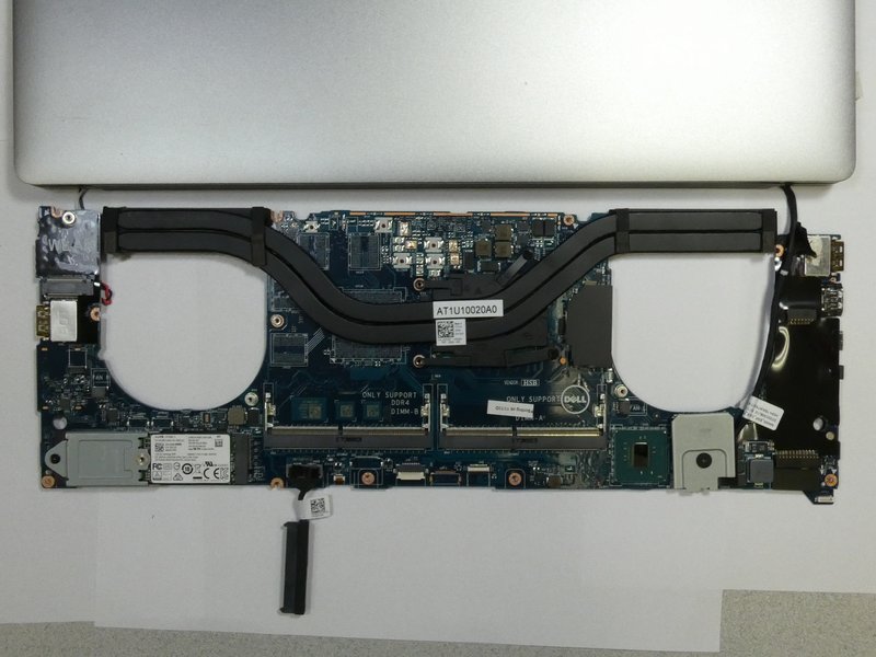

  22. Dell XPS 15 9560 Motherboard Replacement, Motherboard: step 22, image 1 of 1
    • Using a screwdriver, unscrew one 5.0 mm Torx T5 bracket screw.
    • Remove the bracket and unplug and loosen the LCD cable.
  23. Dell XPS 15 9560 Motherboard Replacement: step 23, image 1 of 1
    • Using a T5 Torx screwdriver, remove ten 4.0 mm screws securing the motherboard to the device.
  24. Dell XPS 15 9560 Motherboard Replacement: step 24, image 1 of 1
    • From right to left, unplug the bottom motherboard cables, DC jack cable, speaker cable.
  25. Dell XPS 15 9560 Motherboard Replacement: step 25, image 1 of 1
    • Remove the motherboard.
