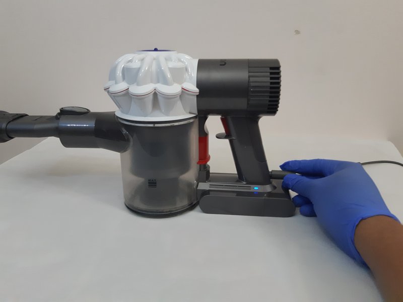

    • Make sure the Dyson is unplugged and off before continuing. This is indicated if there is no light on by the charging port.
    • If there is a blue light on the base of the device just below the handle, the device is on. Make sure no light is on.
    • The light can stay on if you unplug the power adapter from the wall but the plug is still connected to the Dyson.
