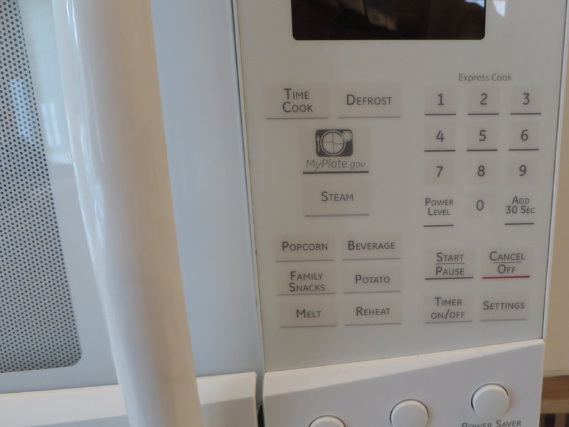

GE Profile Microwave Oven Touchpad Repair
  1. GE Profile Microwave Oven Touchpad Repair, GE Profile Microwave: step 1, image 1 of 3 GE Profile Microwave Oven Touchpad Repair, GE Profile Microwave: step 1, image 2 of 3 GE Profile Microwave Oven Touchpad Repair, GE Profile Microwave: step 1, image 3 of 3
    • These are pictures of the front of our microwave, and the detailed model number. Many GE microwaves have a similar disassembly method.
