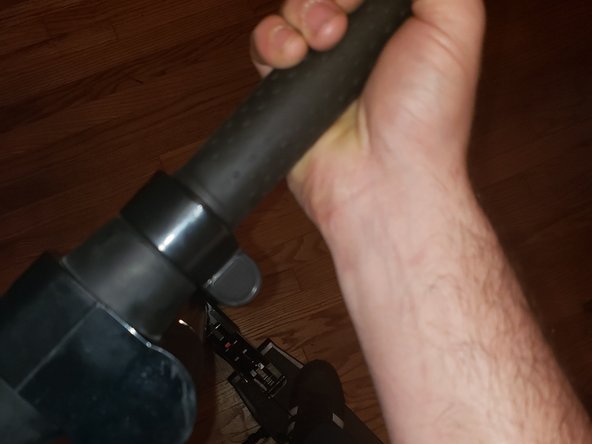

  3. Gotrax GXL Scooter Battery Pack Replacement, Removing the console/head unit: step 3, image 1 of 2 Gotrax GXL Scooter Battery Pack Replacement, Removing the console/head unit: step 3, image 2 of 2
    • Remove the console/head unit from the scooter by putting one foot on the scooters base and lifting up on the handlebars.
    • Tip: Try to lift as straight as possible out of the tiller. Use caution as extreme force may damage your scooter console or battery connections.

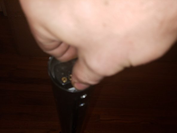

  4. Gotrax GXL Scooter Battery Pack Replacement, Remove the old battery: step 4, image 1 of 3 Gotrax GXL Scooter Battery Pack Replacement, Remove the old battery: step 4, image 2 of 3 Gotrax GXL Scooter Battery Pack Replacement, Remove the old battery: step 4, image 3 of 3
    • Using caution, grab the top of the battery and begin to lift it out of the tiller. As you can see here I was able to do it with my fingers. If you can not grip the top with your fingers use a pair of pliers to assist you. Set the battery to the side for disposal. (Be sure to follow local laws and regulations when disposing lithium ion batteries)
