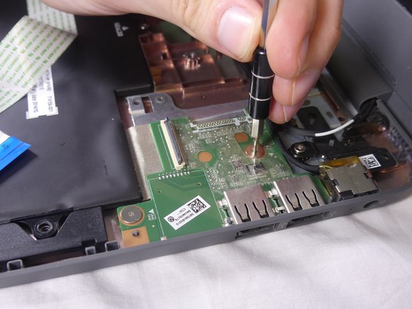

  7. HP Chromebook 14-x013dx I/O Board Replacement: step 7, image 1 of 2 HP Chromebook 14-x013dx I/O Board Replacement: step 7, image 2 of 2
    • Remove two 2mm screws from the I/O board using the Phillips PH00 screwdriver.
  8. HP Chromebook 14-x013dx I/O Board Replacement: step 8, image 1 of 1
    • Lift the I/O board out of the laptop case.
