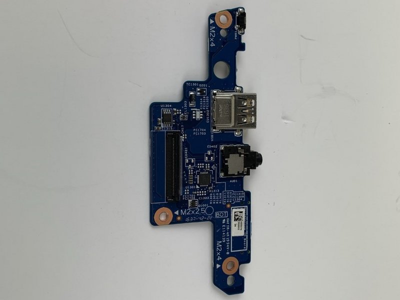

  3. HP Envy x360 m6-aq105dx Audio Jack Replacement, Audio Jack: step 3, image 1 of 1
    • Attach the grounding bracelet's clip to the frame of the laptop, then put on the grounding bracelet.
    • Remove the two 4.6 mm screws using the Phillips #0 screwdriver.
    • Remove the one 4.4mm screw using the Phillips #0 screwdriver.
    • Remove the one 2.8mm screws securing the audio jack/power button board using the Phillips #0 screwdriver.
  4. HP Envy x360 m6-aq105dx Audio Jack Replacement: step 4, image 1 of 2 HP Envy x360 m6-aq105dx Audio Jack Replacement: step 4, image 2 of 2
    • Place the blue plastic opening tool on top of the blue data ribbon and under the connector. Lift up on the blue plastic opening tool to open the connector.
    • Remove the blue data ribbon from the audio board.
  5. HP Envy x360 m6-aq105dx Audio Jack Replacement: step 5, image 1 of 2 HP Envy x360 m6-aq105dx Audio Jack Replacement: step 5, image 2 of 2
    • Remove the audio jack motherboard from the computer.
