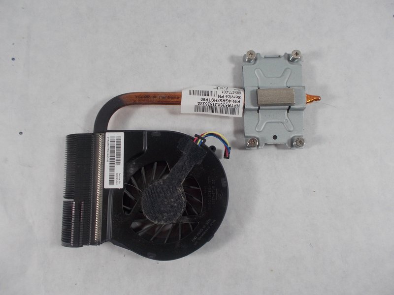

This is a step-by-step guide with images that will show how to open up your HP Pavilion G7-2289wm laptop and replace its fan and heat sink.
A heat sink is a crucial part of a laptop that will help keep your computer or laptop cool and properly working. But once it is at its max life span or it’s not properly cooling your laptop, you can easily remove and replace it to keep your whole laptop working properly.
