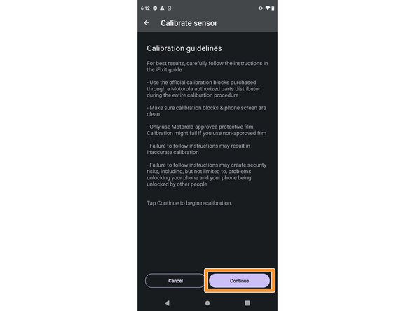

Click the three dots in the top right corner (⋮) again and select Calibrate sensor.
Click Continue twice in the bottom right corner, reading through the information on screen.

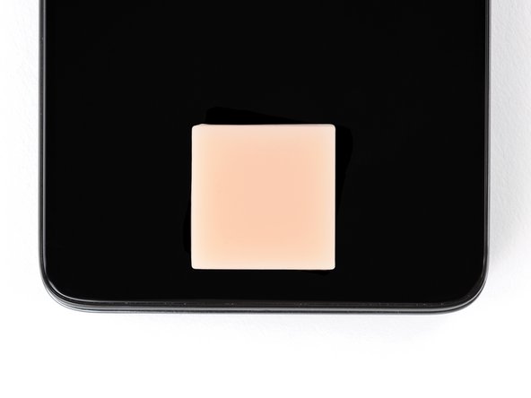

Before starting the calibration, make sure your screen is clean and free of any dust or grime.
Check the three calibration blocks and ensure they're clean and undamaged.

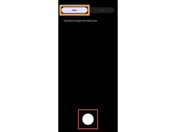

Click Start in the top left corner and follow the instructions on screen to complete the calibration.
Make sure the blocks are aligned with and covering the red square on your screen.

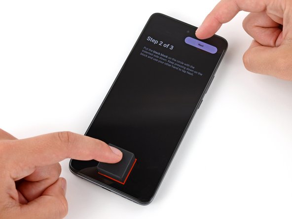

You only need to press gently on the blocks. Don't compress them.
During Step 3, make sure the grooves on the bottom of the block are oriented correctly, as described in the on-screen instructions.
