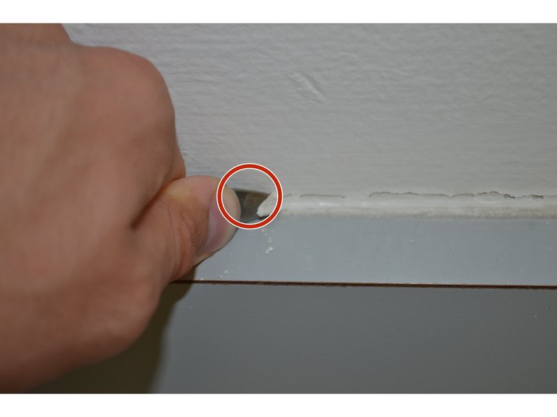

    • Use a knife to uproot the old caulk that is sealed to the wall.
