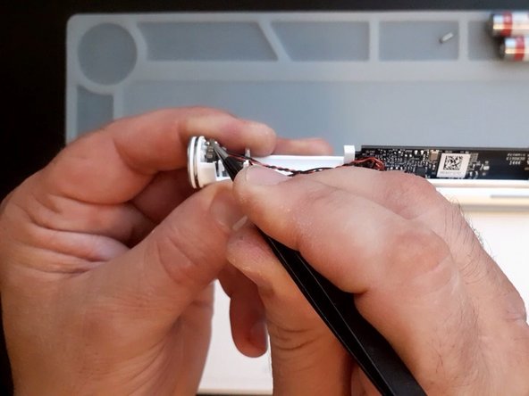

    • As you can see from the photo, the negative pole of the battery is connected to the main board through the aluminum body of the keyboard.
    • There are two contact areas:
    • Between the battery cover and the KB aluminum body
    • Between the power button assemble and the KB aluminum body
    • If the device has a power problem, we need to check and clean these two places

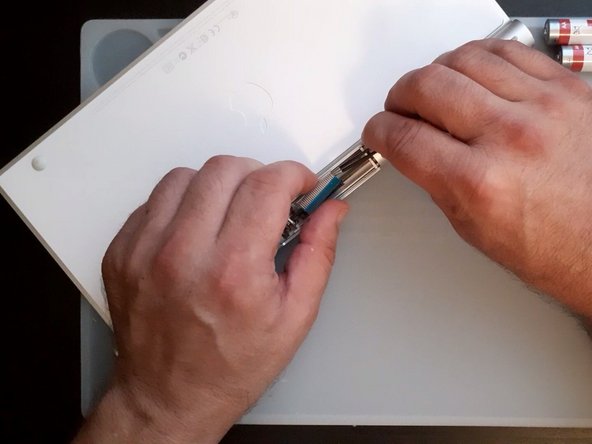

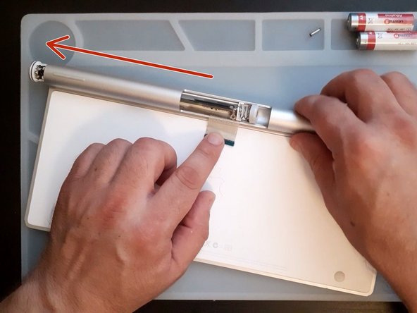

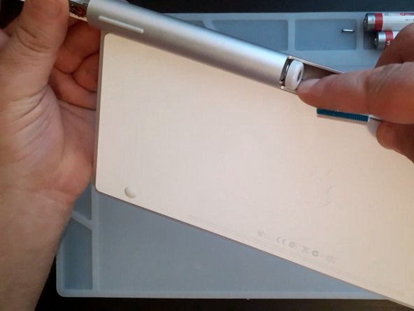

  4. How to Repair Apple Wireless Keyboard A1314 - Doesn't Turn On, Logic Board Removal Part 1: step 4, image 1 of 3 How to Repair Apple Wireless Keyboard A1314 - Doesn't Turn On, Logic Board Removal Part 1: step 4, image 2 of 3 How to Repair Apple Wireless Keyboard A1314 - Doesn't Turn On, Logic Board Removal Part 1: step 4, image 3 of 3
    • Remove the plastic cap from the middle on the tube and disconnect the KB flex cable
    • There are a screw secured the BT antenna, remove it
    • Slide the board out.
    • Be careful for the KB Flex Cable

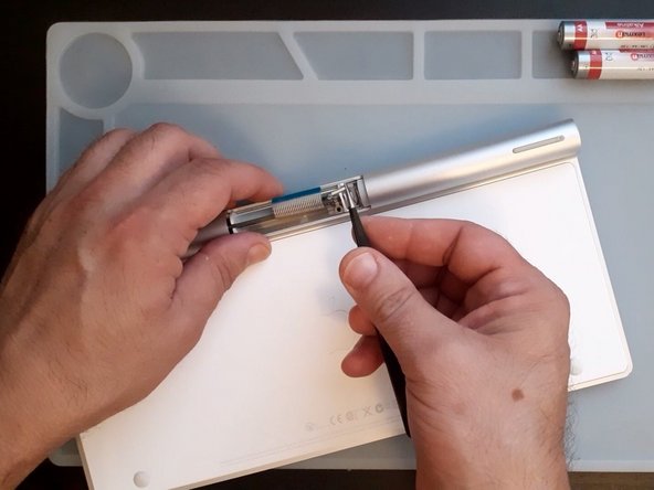

  5. How to Repair Apple Wireless Keyboard A1314 - Doesn't Turn On: step 5, image 1 of 3 How to Repair Apple Wireless Keyboard A1314 - Doesn't Turn On: step 5, image 2 of 3 How to Repair Apple Wireless Keyboard A1314 - Doesn't Turn On: step 5, image 3 of 3
    Tool used on this step:
    Buy
    • Use tweezers or a sharp metal tool and slightly bend the contact plate outwards
    • Clean the tube and the contact plate
    • Install back the logic board plate and be careful for the flex
