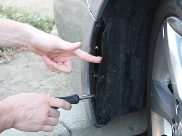

  3. How to Replace the Front-Turn Signal Bulb in a 2011 Subaru Impreza Outback Sport: step 3, image 1 of 2 How to Replace the Front-Turn Signal Bulb in a 2011 Subaru Impreza Outback Sport: step 3, image 2 of 2
    • Use a flathead screwdriver and your hand to loosen the panel.
    • Pry the front bumper open away from the black panel.

My wheel well & bumper was a bit harder to remove (a few more plastic rivets holding it on) but I was able to get it open enough to reach up - easy enough to remove by feel. Thanks for the guide!

The hardest part was removing the little plastic rivets without breaking them. (I broke one.) You will need to remove four plastic rivets total. Three vertical and one on the bottom of the side quarter panel. For some reason two of the rivets have phillips head slots, but the other two have no slots and must be carefully pried.
Once you unscrew the bulb socket, you will need to pull the assembly downward as far as possible in order to get both hands on the bulb.
