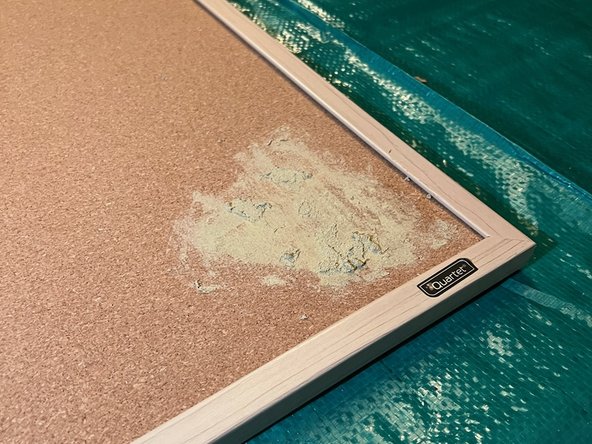

This guide will show how to restore a damaged corkboard that may have holes or tears in it. This fix can be used on any size board. It can be especially useful for boards that are mounted on a wall and are expensive to replace.
  1. How to Restore a Damaged Cork Board, How to Restore a Damaged Cork Board: step 1, image 1 of 1
    • Cover your work surface with a tarp.
  2. How to Restore a Damaged Cork Board: step 2, image 1 of 1
    • Use a rag, soap, and water to scrub the damaged area to remove residual pieces of cork and glue.
    • Allow the area to dry.
  3. How to Restore a Damaged Cork Board: step 3, image 1 of 1
    • Apply wood filler liberally on top of the holes.
  4. How to Restore a Damaged Cork Board: step 4, image 1 of 2 How to Restore a Damaged Cork Board: step 4, image 2 of 2
    • Smooth out the wood filler using a putty knife.
    • Hold the putty knife at an angle and use long strokes to flatten the filler as much as possible.
    • Wait 1 hour for the filler to dry.
  5. How to Restore a Damaged Cork Board: step 5, image 1 of 1
    • Use 80-grit sandpaper to sand down the excess filler in a circular motion.
  6. How to Restore a Damaged Cork Board: step 6, image 1 of 1
    • Cover the damaged area with a thin, even layer of wood sealant.
This guide will help you keep your old cork boards instead of trying to replace them. I hope you found our guide useful.
