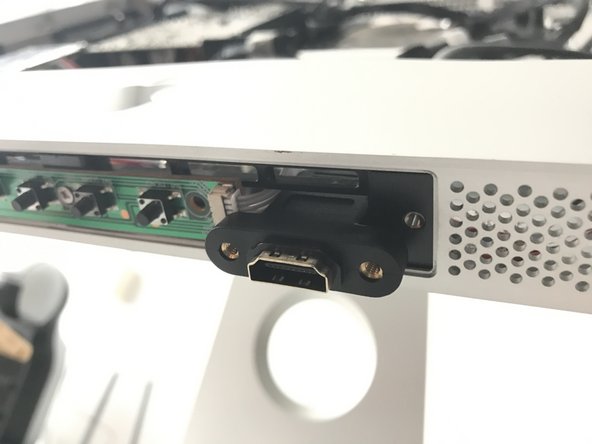

I don't need the VGA connection, so I'll use only the HDMI connection
You can use a long cable, connect it to the board and let it out from the chassis
Or you can also buy an HDMI extender cable and connect it like I did (it's more practical to have a detachable HDMI cable)
