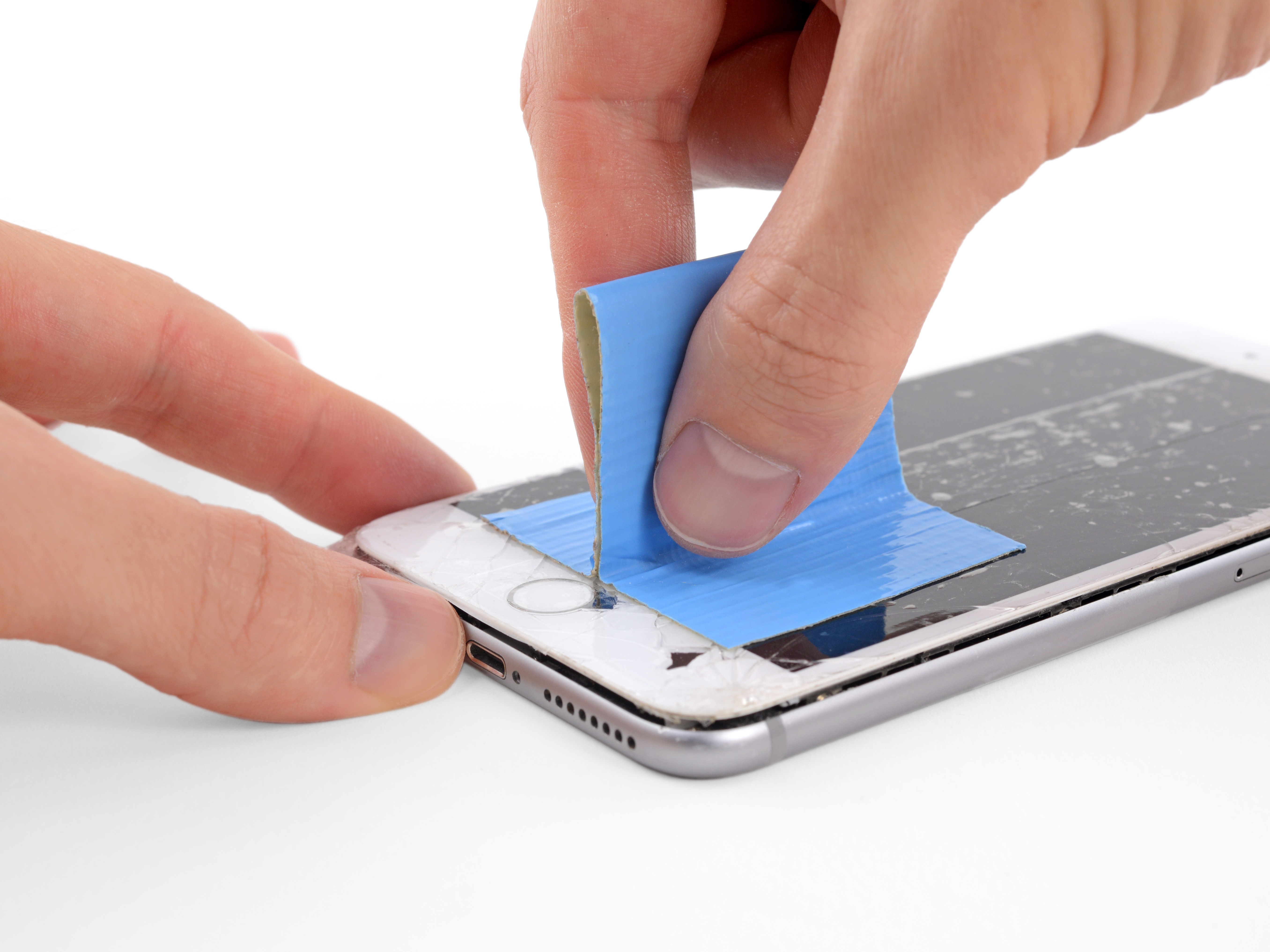

    • If the phone's rear glass is cracked, a suction cup may not stick very well. Try lifting it with strong tape, or superglue the suction cup in place and allow it to cure so you can proceed.
