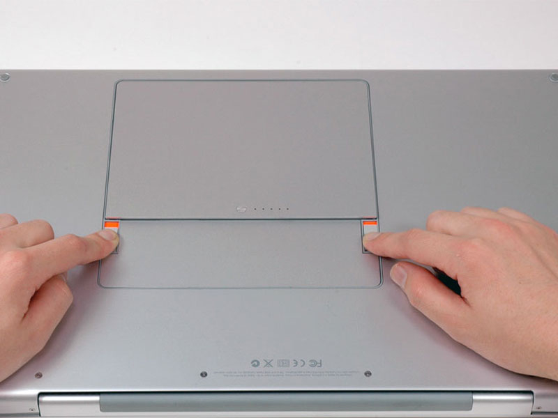

MacBook Pro 17" Models A1151 A1212 A1229 and A1261 Battery Replacement
  1. MacBook Pro 17" Models A1151 A1212 A1229 and A1261 Battery Replacement, Battery: step 1, image 1 of 1
    • Use your fingers to push both battery release tabs away from the battery and lift the battery out of the computer.
