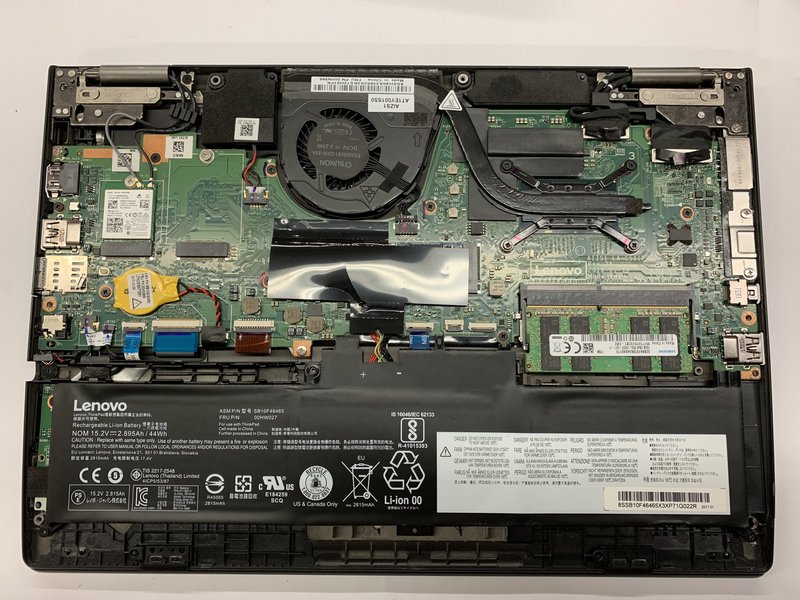

  5. Lenovo ThinkPad Yoga 260 Motherboard Replacement, Battery: step 5, image 1 of 3 Lenovo ThinkPad Yoga 260 Motherboard Replacement, Battery: step 5, image 2 of 3 Lenovo ThinkPad Yoga 260 Motherboard Replacement, Battery: step 5, image 3 of 3
    • Fold back the plastic cover to access the battery connection.
    • Remove the battery connection using your two index fingers.
    • Gently separate the connectors.
  6. Lenovo ThinkPad Yoga 260 Motherboard Replacement: step 6, image 1 of 3 Lenovo ThinkPad Yoga 260 Motherboard Replacement: step 6, image 2 of 3 Lenovo ThinkPad Yoga 260 Motherboard Replacement: step 6, image 3 of 3
    • Unscrew the two 1.3 mm Phillips #1 fasteners using a Phillips #1 screwdriver and set them aside.
    • Lift the battery free from its mounting and remove it.

  15. Lenovo ThinkPad Yoga 260 Motherboard Replacement, Motherboard: step 15, image 1 of 2 Lenovo ThinkPad Yoga 260 Motherboard Replacement, Motherboard: step 15, image 2 of 2
    • Disconnect the speaker cable located near hinge side of the laptop.
    • Remove both speakers from the assembly.
  16. Lenovo ThinkPad Yoga 260 Motherboard Replacement: step 16, image 1 of 3 Lenovo ThinkPad Yoga 260 Motherboard Replacement: step 16, image 2 of 3 Lenovo ThinkPad Yoga 260 Motherboard Replacement: step 16, image 3 of 3
    • Gently lift up the SD chip's black protective film.
    • Using a Phillips #1 screwdriver, remove the 1.3 mm screw and set it aside.
    • Unplug the SD chip from the assembly and set the SD chip aside.
  17. Lenovo ThinkPad Yoga 260 Motherboard Replacement: step 17, image 1 of 3 Lenovo ThinkPad Yoga 260 Motherboard Replacement: step 17, image 2 of 3 Lenovo ThinkPad Yoga 260 Motherboard Replacement: step 17, image 3 of 3
    • Pull up on the 2 black tabs to remove the cords located along the hinge edge of the device.
  18. Lenovo ThinkPad Yoga 260 Motherboard Replacement: step 18, image 1 of 3 Lenovo ThinkPad Yoga 260 Motherboard Replacement: step 18, image 2 of 3 Lenovo ThinkPad Yoga 260 Motherboard Replacement: step 18, image 3 of 3
    • Pull up the 6 colored tabs along the edge of the motherboard to disconnect them from the motherboard.
  19. Lenovo ThinkPad Yoga 260 Motherboard Replacement: step 19, image 1 of 1
    • Remove the fourteen .8 mm screws on the motherboard using a Phillips #00 screwdriver.
    • Carefully lift the motherboard out of assembly.
    • Ensure no wires or cables remain connected.
