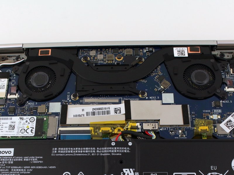

  4. Lenovo Yoga 730-13IKB Heat Sink Replacement, Heat Sink: step 4, image 1 of 2 Lenovo Yoga 730-13IKB Heat Sink Replacement, Heat Sink: step 4, image 2 of 2
    • Use a Phillips #00 screwdriver to remove the eight 2.5mm screws securing the heat sink assembly.
  5. Lenovo Yoga 730-13IKB Heat Sink Replacement: step 5, image 1 of 2 Lenovo Yoga 730-13IKB Heat Sink Replacement: step 5, image 2 of 2
    • Release the fan connector by gently pushing the gray locking tab up using a plastic spudger. Do this for both of the fans.
    • Pull each fan cable straight out of the connector.
  6. Lenovo Yoga 730-13IKB Heat Sink Replacement: step 6, image 1 of 1
    • Remove the heat sink assembly by holding the middle plate and rotating the assembly down towards the back of the motherboard.
    • Pull the heat sink diagonally away from the laptop.
