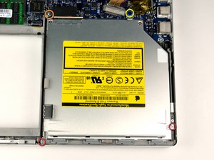

    • Remove the following 4 screws:
    • Two 3.3 mm silver Phillips screws on either side of the SuperDrive.
    • One 4.7 mm silver T6 Torx screw from the top left corner of the drive.
    • One 6.2 mm black Phillips screw at the top right corner of the drive.
    • Lift the optical drive up and out of the computer.

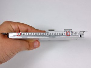

    • Remove the two silver Phillips screws securing the mounting bracket to the left side of the optical drive.

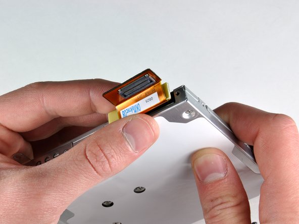

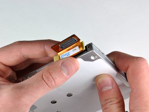

    • Rotate the drive and disconnect the orange ribbon cable from the optical drive.

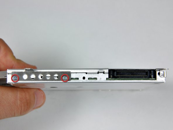

    • Remove the two Phillips screws securing the mounting bracket to the rear of the optical drive.

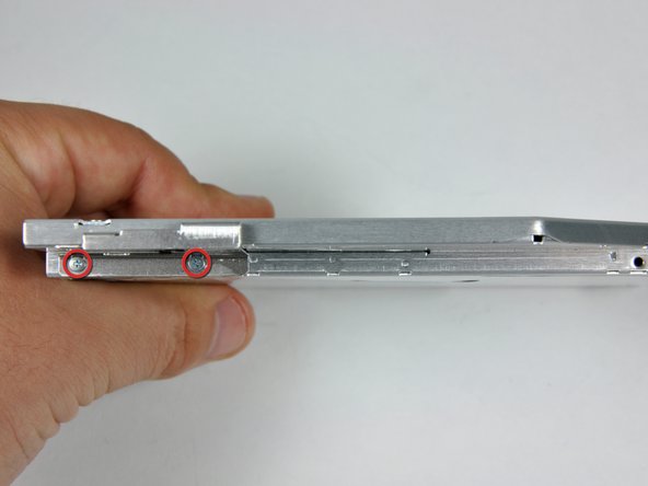

    • Rotate the drive and remove the two Phillips screws securing the mounting bracket to the right side of the optical drive.
