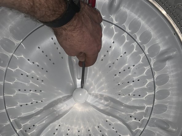

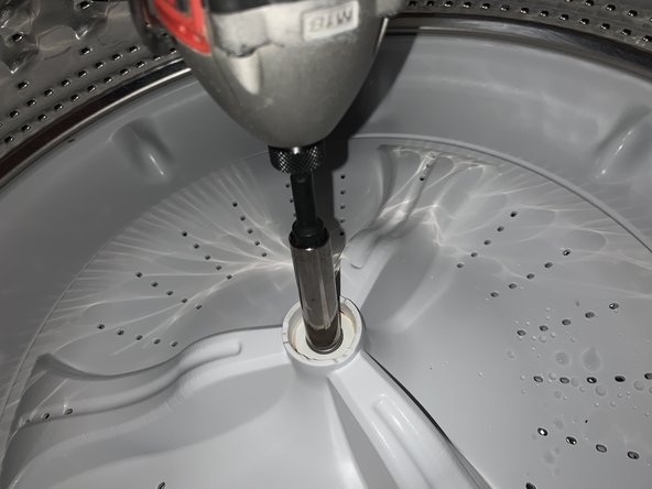

  3. Maytag MVWX655DW1 Washer Basket Hub Replacement: step 3, image 1 of 3 Maytag MVWX655DW1 Washer Basket Hub Replacement: step 3, image 2 of 3 Maytag MVWX655DW1 Washer Basket Hub Replacement: step 3, image 3 of 3
    • Remove the cap from the agitator with your flat head screwdriver. It should pop right off.
    • Using your 7/16 socket, unscrew the bolt attaching the agitator to the motor shaft.

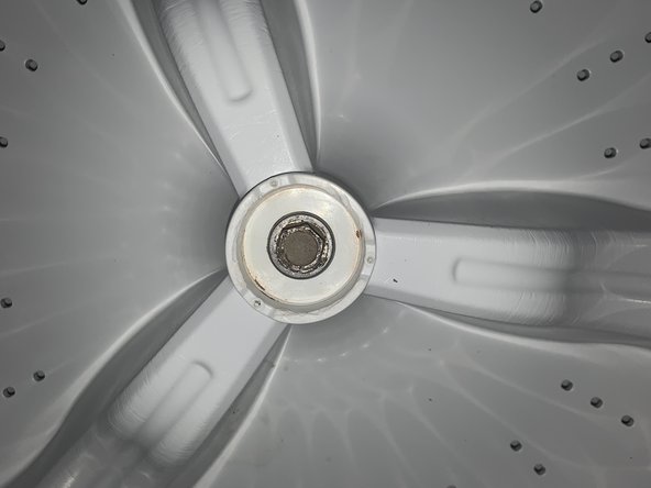

  4. Maytag MVWX655DW1 Washer Basket Hub Replacement: step 4, image 1 of 3 Maytag MVWX655DW1 Washer Basket Hub Replacement: step 4, image 2 of 3 Maytag MVWX655DW1 Washer Basket Hub Replacement: step 4, image 3 of 3

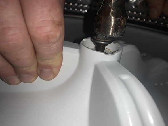

    • Lift up on the agitator and it should slide off the motor shaft exposing the washer hub underneath.
    • If it is stuck, put bolt back in halfway. Tap the bolt with a hammer while pulling up on the agitator to jog it loose.

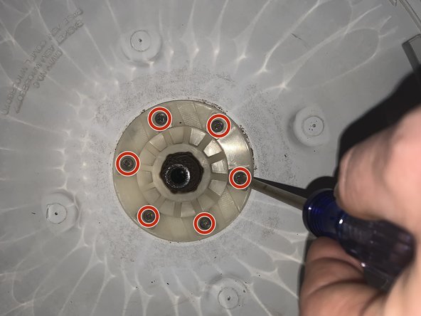

  5. Maytag MVWX655DW1 Washer Basket Hub Replacement: step 5, image 1 of 3 Maytag MVWX655DW1 Washer Basket Hub Replacement: step 5, image 2 of 3 Maytag MVWX655DW1 Washer Basket Hub Replacement: step 5, image 3 of 3
    • Use your Phillips #3 screwdriver to pull the retaining slip out.
    • Unscrew the six screws with the same Phillips #3 screwdriver to remove the hub.
