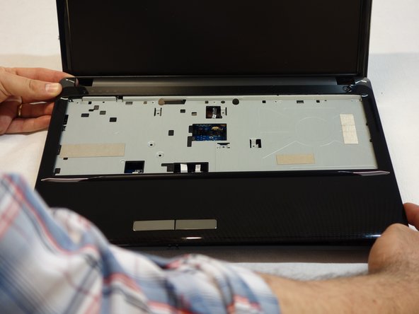

  17. Motherboard by why! Replace W253EU: step 17, image 1 of 3 Motherboard by why! Replace W253EU: step 17, image 2 of 3 Motherboard by why! Replace W253EU: step 17, image 3 of 3
    • Proceed with the removal of the keyboard bezel in the clockwise direction.
    • Remove the keyboard frame and the motherboard appears.

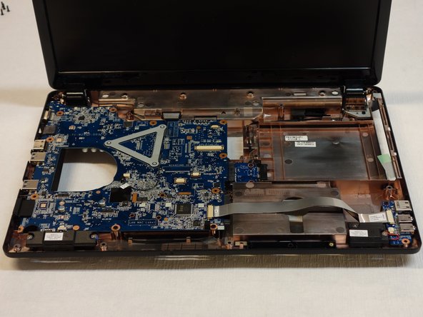

  18. Motherboard by why! Replace W253EU: step 18, image 1 of 2 Motherboard by why! Replace W253EU: step 18, image 2 of 2
    • Unplug the main connector.
    • Unplug the small connector in the middle.

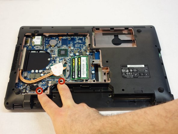

  19. Motherboard by why! Replace W253EU: step 19, image 1 of 3 Motherboard by why! Replace W253EU: step 19, image 2 of 3 Motherboard by why! Replace W253EU: step 19, image 3 of 3
    • Turn the computer over and unplug the connector near the processor (CPU).
    • Remove the other connector that is immediately to the right of it.
    • Using a Philips #1 screwdriver, remove the 2 mounting screws of the Wi-Fi chipset.
  20. Motherboard by why! Replace W253EU: step 20, image 1 of 3 Motherboard by why! Replace W253EU: step 20, image 2 of 3 Motherboard by why! Replace W253EU: step 20, image 3 of 3
    • Unplug the plug that is positioned in the back
    • Disconnect the small connector that is right next to the first connector.
    • With a Philips #1 screwdriver, remove the screws outlined in red.
  21. Motherboard by why! Replace W253EU: step 21, image 1 of 3 Motherboard by why! Replace W253EU: step 21, image 2 of 3 Motherboard by why! Replace W253EU: step 21, image 3 of 3
    • Using a Philips #1 screwdriver, remove the 10 mounting screws from the motherboard.
    • Disconnect the small connector that is located in the front.
    • With a Philips #1 screwdriver, remove the 2 screws that are crosswise and marked with blue circles.
    • Take out the motherboard.
