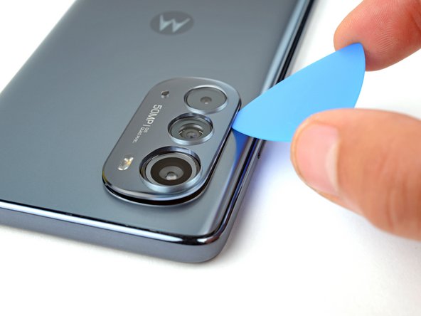

  2. Motorola Edge (2022) Camera Bezel Replacement, Insert an opening pick: step 2, image 1 of 2 Motorola Edge (2022) Camera Bezel Replacement, Insert an opening pick: step 2, image 2 of 2
    • Insert an opening pick between the camera bezel and the back cover.
  3. Motorola Edge (2022) Camera Bezel Replacement, Slice the camera bezel adhesive: step 3, image 1 of 2 Motorola Edge (2022) Camera Bezel Replacement, Slice the camera bezel adhesive: step 3, image 2 of 2
    • Slide the pick around the perimeter of the camera bezel to slice all the adhesive securing the bezel.
    • You may have to repeat this process multiple times to completely cut all of the adhesive.

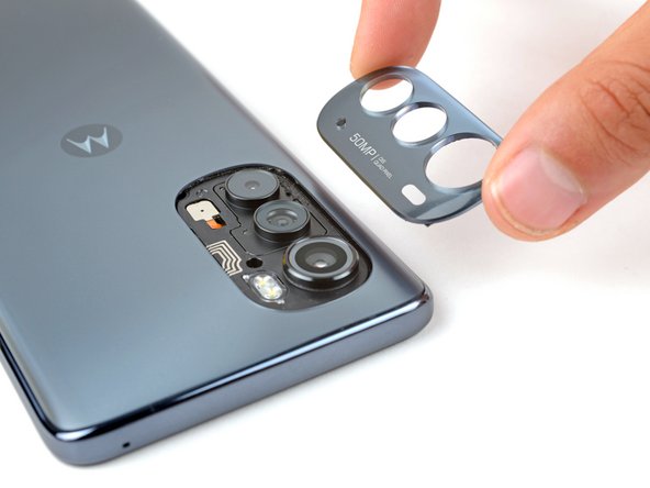

  4. Motorola Edge (2022) Camera Bezel Replacement, Remove the camera bezel: step 4, image 1 of 2 Motorola Edge (2022) Camera Bezel Replacement, Remove the camera bezel: step 4, image 2 of 2
    • Lift the camera bezel away from the phone and remove it.
To reassemble your device, follow the instructions in reverse order.
