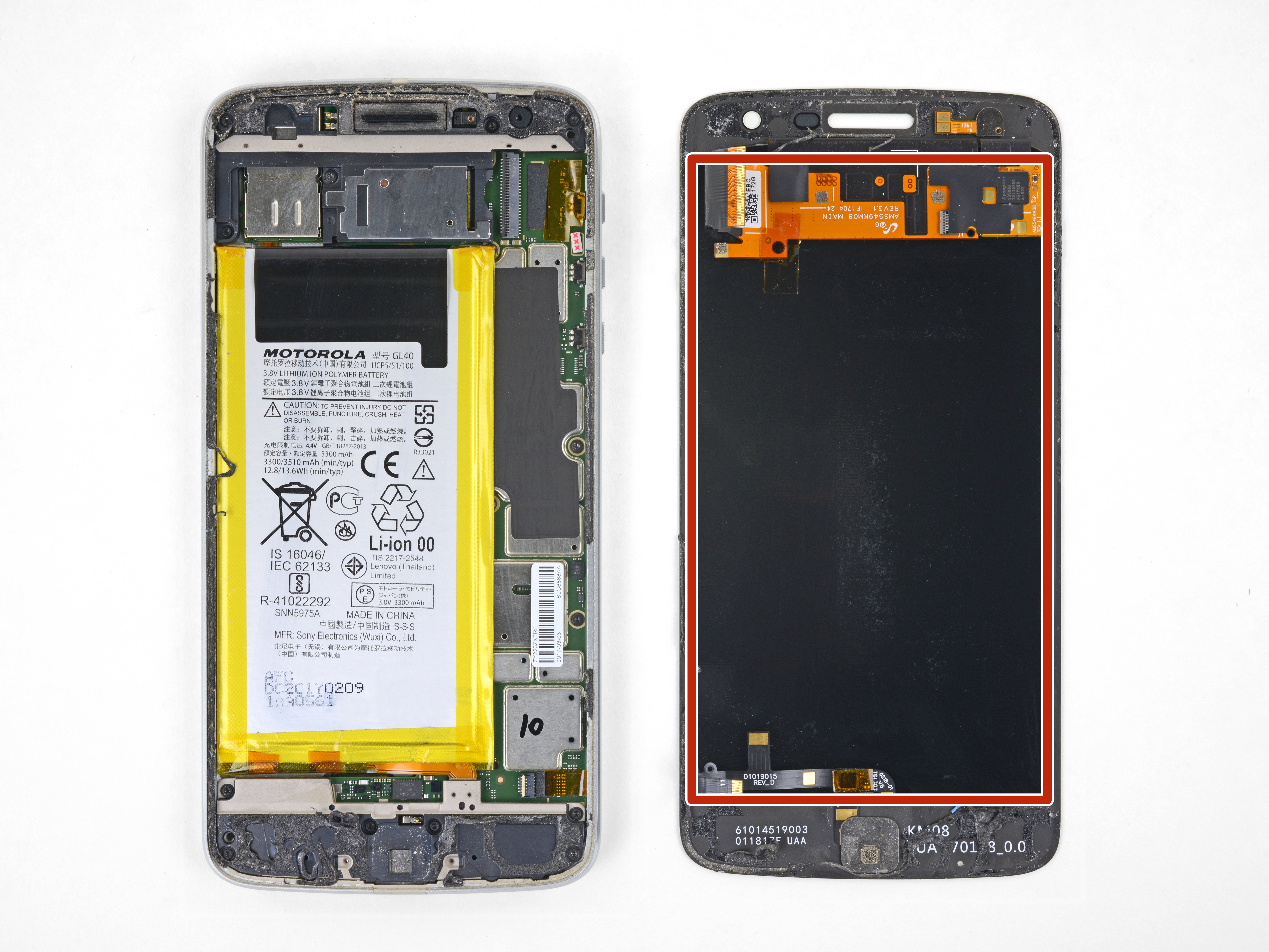

  20. Motorola Moto Z Play Screen Replacement, Display Components: step 20, image 1 of 1
    • If your replacement display does not already include a flash assembly and fingerprint sensor, complete the following steps to transfer those components from your old display to your new display.
    • Apply heat for 2-3 minutes to the bezel area below the display on your old display assembly, in order to soften the adhesive securing the fingerprint sensor.

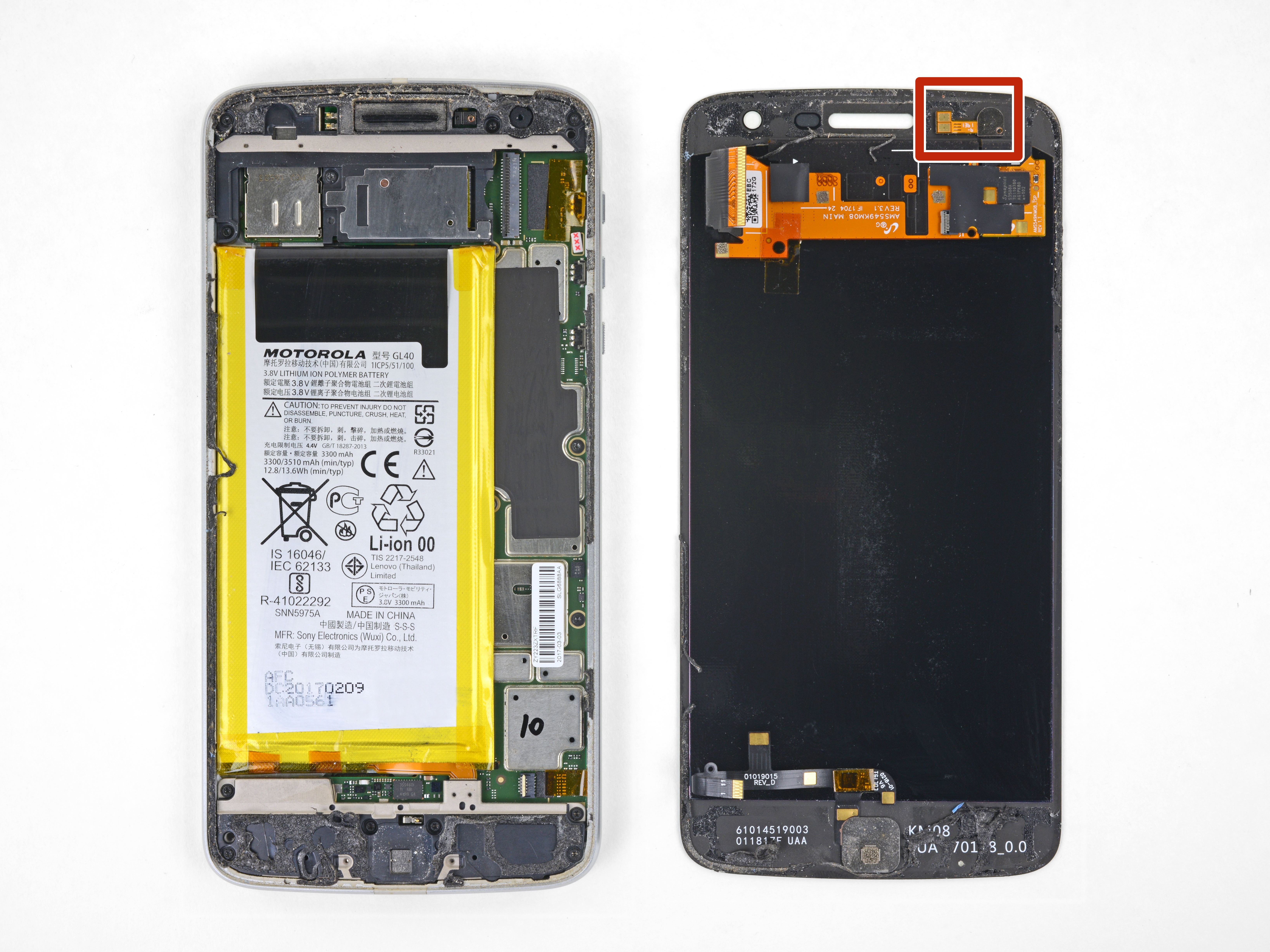

    • Apply heat for 2-3 minutes to the top bezel area above the display on your old display assembly, in order to soften the adhesive securing the front camera flash.
  25. Motorola Moto Z Play Screen Replacement: step 25, image 1 of 2 Motorola Moto Z Play Screen Replacement: step 25, image 2 of 2
    • Use the point of a spudger to push the outward-facing side of the camera flash until it separates from the display assembly.
  26. Motorola Moto Z Play Screen Replacement: step 26, image 1 of 2 Motorola Moto Z Play Screen Replacement: step 26, image 2 of 2
    • Slide an opening pick underneath the flash flex cable, and carefully cut through the adhesive securing it in place.
    • Remove the front camera flash and set it aside.

  30. Motorola Moto Z Play Screen Replacement: step 30, image 1 of 2 Motorola Moto Z Play Screen Replacement: step 30, image 2 of 2
    • Use the flash assembly and a fine-point pen or marker to trace out an appropriately-sized piece of double-sided adhesive tape.
    • Cut the tape to about the right size and shape and apply it to the front-facing side of the flash assembly.

    • Remove any protective tapes or films from the back of your new display assembly.

    • Peel away the liner from the adhesive tape on the flash assembly, and press the flash into place on the back of the new display.
    • Be sure to install the flash assembly in its original, horizontal alignment, or the copper pads on the back won't line up with the spring contacts in the phone, and your flash won't work.
