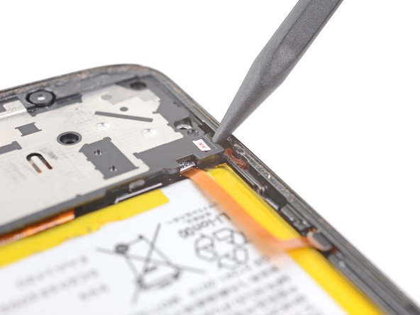

  18. Motorola Moto Z3 Battery Replacement: step 18, image 1 of 2 Motorola Moto Z3 Battery Replacement: step 18, image 2 of 2
    • Insert the point of a spudger into the small rectangular opening on the right edge of the earpiece speaker and sensor assembly.
    • Use the spudger to pry the assembly up and release the clips securing it to the phone chassis.
  19. Motorola Moto Z3 Battery Replacement: step 19, image 1 of 1
    • Remove the earpiece speaker and sensor assembly.
    • The earpiece speaker connector sits under the assembly and will disconnect as you lift the assembly. During reassembly, make sure to reconnect this connector.
