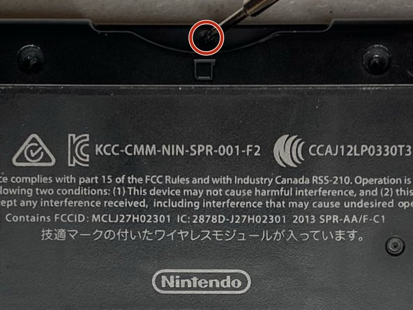

  5. Nintendo 3DS XL Left Bumper Replacement: step 5, image 1 of 2 Nintendo 3DS XL Left Bumper Replacement: step 5, image 2 of 2
    • Remove the screw near the game card compartment using a Phillips #00 screwdriver.

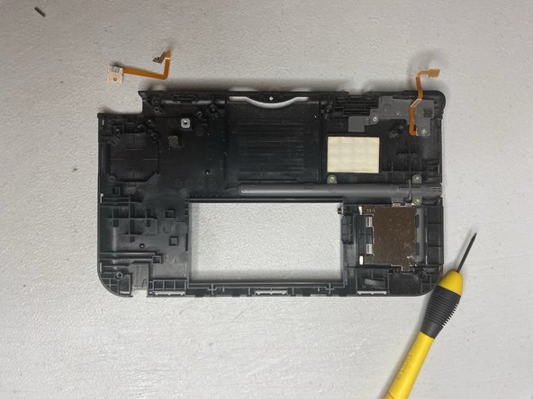

  7. Nintendo 3DS XL Left Bumper Replacement: step 7, image 1 of 2 Nintendo 3DS XL Left Bumper Replacement: step 7, image 2 of 2
    • Remove the three left bumper assembly screws using Phillips #00 screwdriver.
    • Once the three screws are removed, gently remove the left bumper assembly from the device.
    • The spring may eject from the assembly as you remove it.
    • Remove the hinge pin from the bumper assembly.
  8. Nintendo 3DS XL Left Bumper Replacement: step 8, image 1 of 1
    • Separate the bumper from the bumper assembly

    • Using a spudger or a flathead screwdriver, gently pull the ribbon cable straight out of the connector in order to remove it.
    • The ribbon cable can be removed by other means such as using gloves or a microfiber cloth if preferred.
    • Replace the left bumper ribbon cable.
