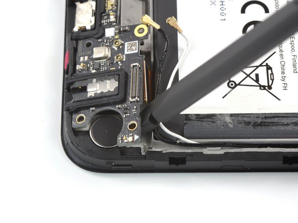

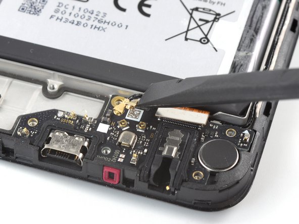

  20. Nokia G42 5G Charging Port Assembly Replacement, Disconnect the antenna cables: step 20, image 1 of 3 Nokia G42 5G Charging Port Assembly Replacement, Disconnect the antenna cables: step 20, image 2 of 3 Nokia G42 5G Charging Port Assembly Replacement, Disconnect the antenna cables: step 20, image 3 of 3
    • Use a spudger to disconnect the antenna cables by prying their coaxial connectors straight up from the sockets on the board.
  21. Nokia G42 5G Charging Port Assembly Replacement, Reposition the antenna cables: step 21, image 1 of 3 Nokia G42 5G Charging Port Assembly Replacement, Reposition the antenna cables: step 21, image 2 of 3 Nokia G42 5G Charging Port Assembly Replacement, Reposition the antenna cables: step 21, image 3 of 3
    Tool used on this step:
    Buy
    • Use a pair of tweezers or your fingers to grip the antenna cables near the connectors.
    • Reposition the antenna cables out of the way of the charging port assembly.

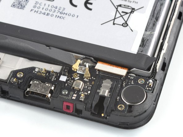

  22. Nokia G42 5G Charging Port Assembly Replacement, Pry up the charging port assembly: step 22, image 1 of 3 Nokia G42 5G Charging Port Assembly Replacement, Pry up the charging port assembly: step 22, image 2 of 3 Nokia G42 5G Charging Port Assembly Replacement, Pry up the charging port assembly: step 22, image 3 of 3
    • The charging port assembly is held in place with mild adhesive.
    • Insert the flat end of a spudger underneath the top right edge of the charging port assembly.
    • Pivot the charging port assembly up until you can grip it with your fingers.
  23. Nokia G42 5G Charging Port Assembly Replacement, Remove the charging port assembly: step 23, image 1 of 2 Nokia G42 5G Charging Port Assembly Replacement, Remove the charging port assembly: step 23, image 2 of 2
    • Use your fingers or a pair of tweezers to remove the charging port assembly.

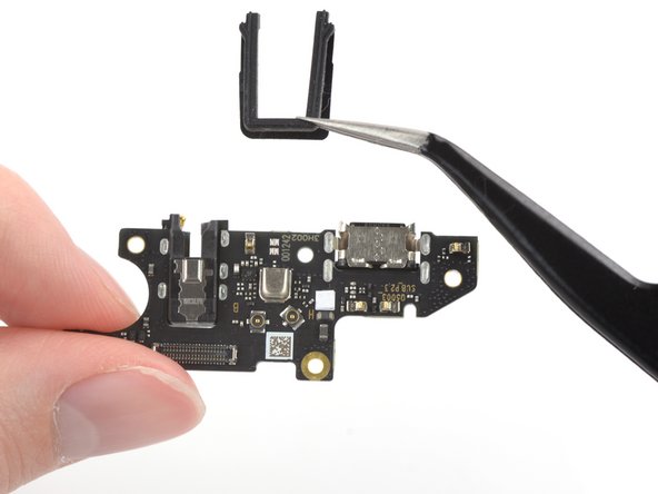

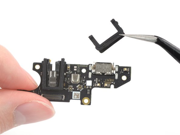

  24. Nokia G42 5G Charging Port Assembly Replacement, Remove the rubber gaskets: step 24, image 1 of 3 Nokia G42 5G Charging Port Assembly Replacement, Remove the rubber gaskets: step 24, image 2 of 3 Nokia G42 5G Charging Port Assembly Replacement, Remove the rubber gaskets: step 24, image 3 of 3
    • Use a pair of tweezers to remove the two black U-shaped rubber gaskets from the charging port and the headphone jack.
    • Only the charging port assembly remains.
    • During reassembly, transfer the rubber gaskets to the replacement board before securing it back into the frame.
