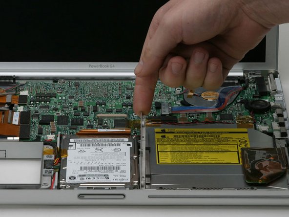

  15. PowerBook G4 Aluminum 15" 1-1.5 GHz Hard Drive Replacement, Hard Drive: step 15, image 1 of 1
    • Remove the two 6 mm long silver Phillips screws from the metal bracket to the right of the hard drive, removing tape as necessary.
  16. PowerBook G4 Aluminum 15" 1-1.5 GHz Hard Drive Replacement: step 16, image 1 of 1
    • Use a spudger to lift the metal bracket out of the computer.

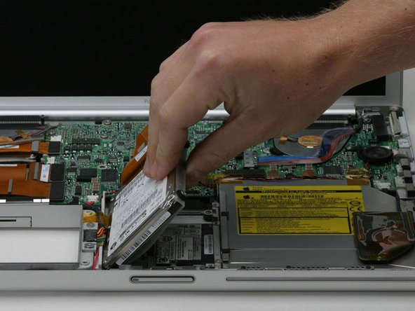

  19. PowerBook G4 Aluminum 15" 1-1.5 GHz Hard Drive Replacement: step 19, image 1 of 1
    • Lift the hard drive up from the right side and remove it from the computer.
