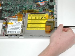

  11. PowerBook G4 Aluminum 15" 1.5-1.67 GHz PRAM Battery Replacement, PRAM Battery: step 11, image 1 of 1
    • Use a spudger to pry up the PRAM battery from the optical drive.
  12. PowerBook G4 Aluminum 15" 1.5-1.67 GHz PRAM Battery Replacement: step 12, image 1 of 1
    • Disconnect the PRAM battery cable from the logic board and pull the PRAM battery out, removing tape as necessary.
