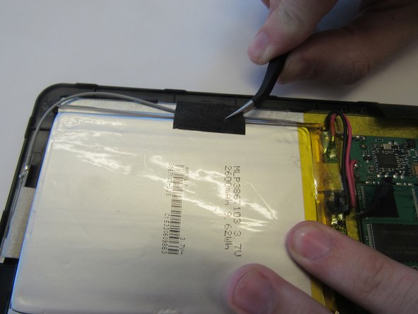

    • Remove the two black tape strips from the battery pack.

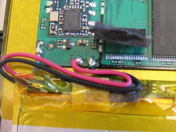

    • Remove the battery pack by carefully prying the battery back from the front cover. Then remove the wires connecting the battery to the motherboard at the motherboard using the tweezers.

    • Replace the damaged or malfunctioning battery with the new battery and wires. The new battery must be stuck back into its original place using thermal tape.
  6. RCA RCT6378W2 Battery Replacement: step 6, image 1 of 3 RCA RCT6378W2 Battery Replacement: step 6, image 2 of 3 RCA RCT6378W2 Battery Replacement: step 6, image 3 of 3
    • The new wires must be soldered back into place on the motherboard at the original location.
