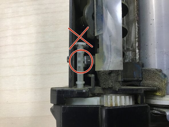

  5. Repairing the Intermediate Transfer Belt (ITB), Remove the toner collector - second side preparation: step 6, image 1 of 3 Repairing the Intermediate Transfer Belt (ITB), Remove the toner collector - second side preparation: step 6, image 2 of 3 Repairing the Intermediate Transfer Belt (ITB), Remove the toner collector - second side preparation: step 6, image 3 of 3
    • Before removing the cover on the second side, notice the position of the white plastic peg.
    • It is easy for this peg to rotate to the wrong place on re-assembly, then you will see the white peg protrude outside the black plastic framework, and the belt will make a loud clicking noise when it is re-installed in the printer.
