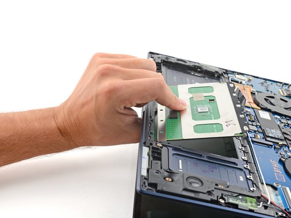

  15. Samsung Galaxy Book Pro 360 15" Touchpad Replacement, Remove the touchpad: step 15, image 1 of 3 Samsung Galaxy Book Pro 360 15" Touchpad Replacement, Remove the touchpad: step 15, image 2 of 3 Samsung Galaxy Book Pro 360 15" Touchpad Replacement, Remove the touchpad: step 15, image 3 of 3
    • Open the laptop to about a 45 degree angle, keeping the laptop upside down.
    • Push up on the touchpad until its top edge is freed from the frame.
    • Pull the touchpad towards the top of the laptop and remove it.
    • Before securing the touchpad, insert its bottom edge under the bracket on the bottom edge of the laptop.
