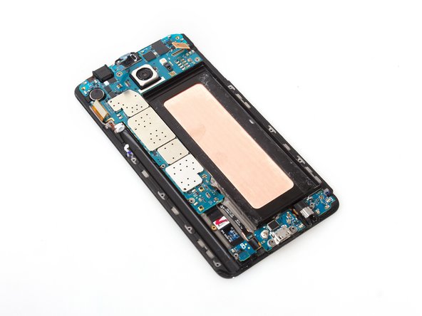

    • Remove SIM card tray.
  2. Samsung Galaxy Note5 rear camera & front camera & earpiece Replacement: step 2, image 1 of 3 Samsung Galaxy Note5 rear camera & front camera & earpiece Replacement: step 2, image 2 of 3 Samsung Galaxy Note5 rear camera & front camera & earpiece Replacement: step 2, image 3 of 3
    • Remove S Pen.
  3. Samsung Galaxy Note5 rear camera & front camera & earpiece Replacement: step 3, image 1 of 3 Samsung Galaxy Note5 rear camera & front camera & earpiece Replacement: step 3, image 2 of 3 Samsung Galaxy Note5 rear camera & front camera & earpiece Replacement: step 3, image 3 of 3
    • Remove back cover.
  4. Samsung Galaxy Note5 rear camera & front camera & earpiece Replacement: step 4, image 1 of 2 Samsung Galaxy Note5 rear camera & front camera & earpiece Replacement: step 4, image 2 of 2
    • Remove screws.
  5. Samsung Galaxy Note5 rear camera & front camera & earpiece Replacement: step 5, image 1 of 3 Samsung Galaxy Note5 rear camera & front camera & earpiece Replacement: step 5, image 2 of 3 Samsung Galaxy Note5 rear camera & front camera & earpiece Replacement: step 5, image 3 of 3
    • Remove middle housing.
  6. Samsung Galaxy Note5 rear camera & front camera & earpiece Replacement: step 6, image 1 of 3 Samsung Galaxy Note5 rear camera & front camera & earpiece Replacement: step 6, image 2 of 3 Samsung Galaxy Note5 rear camera & front camera & earpiece Replacement: step 6, image 3 of 3
    • Remove battery. But it's not necessary. You also can just release battery connector from motherboard.
  7. Samsung Galaxy Note5 rear camera & front camera & earpiece Replacement: step 7, image 1 of 3 Samsung Galaxy Note5 rear camera & front camera & earpiece Replacement: step 7, image 2 of 3 Samsung Galaxy Note5 rear camera & front camera & earpiece Replacement: step 7, image 3 of 3
    • Release the connector on the board.
  8. Samsung Galaxy Note5 rear camera & front camera & earpiece Replacement: step 8, image 1 of 2 Samsung Galaxy Note5 rear camera & front camera & earpiece Replacement: step 8, image 2 of 2
    • Release the USB board connector on the back and remove the motherboard from front assembly.
  9. Samsung Galaxy Note5 rear camera & front camera & earpiece Replacement: step 9, image 1 of 3 Samsung Galaxy Note5 rear camera & front camera & earpiece Replacement: step 9, image 2 of 3 Samsung Galaxy Note5 rear camera & front camera & earpiece Replacement: step 9, image 3 of 3
    • Remove rear camera.
  10. Samsung Galaxy Note5 rear camera & front camera & earpiece Replacement: step 10, image 1 of 2 Samsung Galaxy Note5 rear camera & front camera & earpiece Replacement: step 10, image 2 of 2
    • Remove front camera and noise-canceling mic.
  11. Samsung Galaxy Note5 rear camera & front camera & earpiece Replacement: step 11, image 1 of 3 Samsung Galaxy Note5 rear camera & front camera & earpiece Replacement: step 11, image 2 of 3 Samsung Galaxy Note5 rear camera & front camera & earpiece Replacement: step 11, image 3 of 3
    • Remove earpiece assembly.
  12. Samsung Galaxy Note5 rear camera & front camera & earpiece Replacement: step 12, image 1 of 1
    • That's earpiece with sensors.
