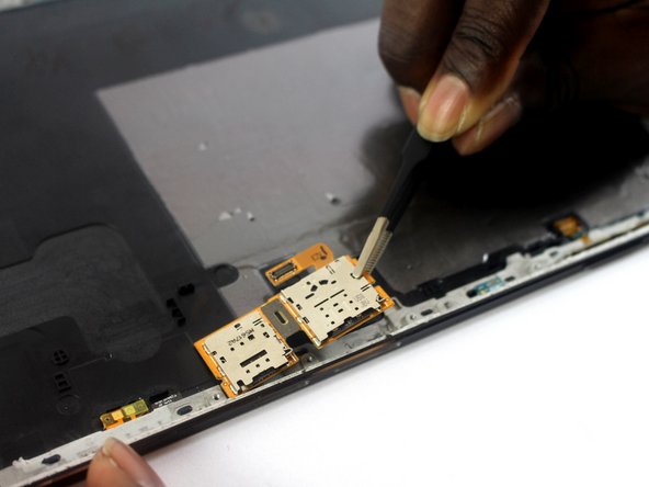

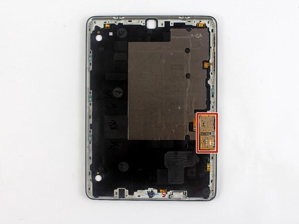

  8. Samsung Galaxy Tab S2 9.7 AT&T SIM Card Holder Replacement, SIM Card Holder: step 8, image 1 of 2 Samsung Galaxy Tab S2 9.7 AT&T SIM Card Holder Replacement, SIM Card Holder: step 8, image 2 of 2
    Tool used on this step:
    Buy
    • Locate the SIM card and the memory card holders along the right side of the tablet.
    • Using the precision tweezers, remove the SIM card and memory card holders.
