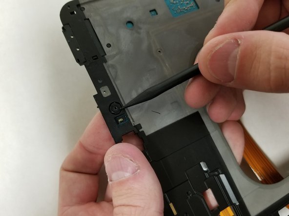

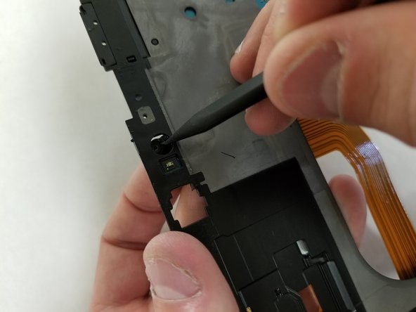

  12. Samsung Galaxy Tab S3 Front Facing Camera Replacement, Front Facing Camera: step 12, image 1 of 3 Samsung Galaxy Tab S3 Front Facing Camera Replacement, Front Facing Camera: step 12, image 2 of 3 Samsung Galaxy Tab S3 Front Facing Camera Replacement, Front Facing Camera: step 12, image 3 of 3
    • Using a nylon spudger, carefully push the camera out of its framing.
    • Unlike the rear facing camera, you will be pushing this camera out from the front. Try to push on the side of the camera so as to not damage the lens with the pointy end of the spudger.
