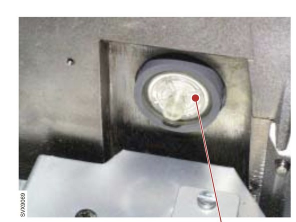

  5. Siemens-Maquet Servo-i Filter for the Inspiration Pressure Transducer Replacement, Filter for the Inspiration Pressure Transducer: step 5, image 1 of 1
    • Locate the inspiratory pressure transducer filter shown by C in the image.
  6. Siemens-Maquet Servo-i Filter for the Inspiration Pressure Transducer Replacement: step 6, image 1 of 1
    • Replace the filter for the inspiratory pressure transducer.
    • Service Manual 7 - 4
  7. Siemens-Maquet Servo-i Filter for the Inspiration Pressure Transducer Replacement: step 7, image 1 of 1
    • Make sure that the filter is correctly seated into the rubber ring.
    • Note: This filter may already be replaced as a part of the 'Extended cleaning of Inspiratory channel' performed in combination with the Preventive maintenance.
