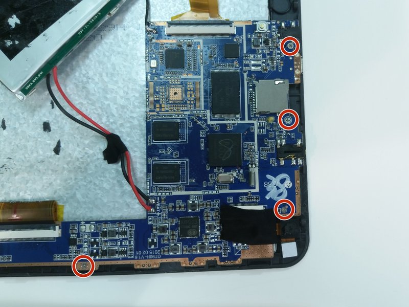

  4. Tagital T9X Screen Replacement, Screen: step 4, image 1 of 1
    • Remove the four 2mm Phillips head screws from the motherboard.
