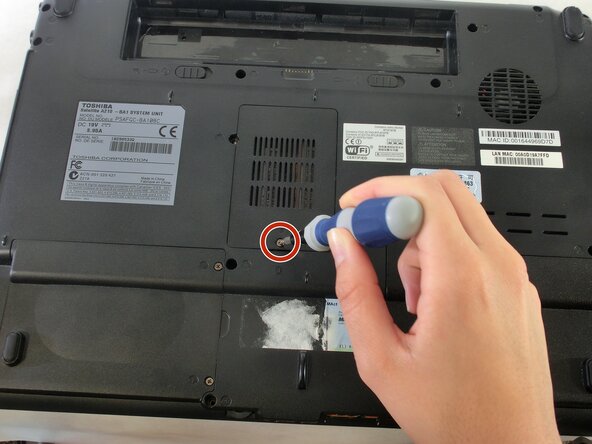

    • Remove the screw holding the RAM cover with a PH1 screwdriver.
    • Remove the RAM cover.

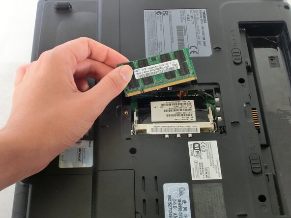

    • Push outwards on the metal tabs to release the RAM.
    • Remove the RAM. Some force may be needed.
    • Be careful not to touch the gold pins on the RAM chips as there may be a build-up of static electricity. This can fry the parts of the chip that houses memory.
In order to reassemble your device, follow these instructions in reverse order.
