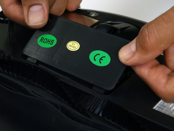

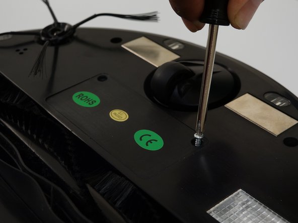

    • Unscrew the battery's cover plate on bObsweep's underside, above the main brush.
    • Lift the cover plate to expose the battery.

    • Lower the cover down so it lies flat and the screw holes of the cover line up with those on bObsweep.
    • Reinstall the two screws removed in step one to secure the cover and battery in place.
