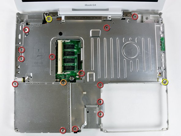

  28. iBook G4 14" 1.42 GHz Hard Drive Replacement, Top Shield: step 28, image 1 of 1
    • Remove the following 16 screws:
    • Thirteen 3 mm Phillips.
    • One 3 mm Phillips.
    • Two 4 mm Phillips.
    • During reassembly, be sure to fit the screw near the left hinge through the loop in the display data cable, securing the cable to the upper case.
  29. iBook G4 14" 1.42 GHz Hard Drive Replacement: step 29, image 1 of 1
    • Lift the top shield up from the right side, minding the upper left corner which may catch on the metal framework.

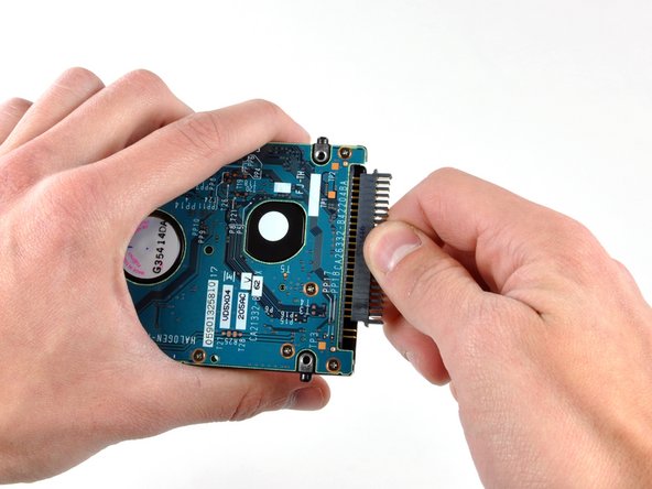

  34. iBook G4 14" 1.42 GHz Hard Drive Replacement: step 34, image 1 of 1
    • Disconnect the hard drive connector from the hard drive.
    • This is a bit tricky. Try rocking the connector gently from side to side while applying even pressure. If you bend the pins, do your best to straighten them, using the hard drive cable as a guide.
    • If you are installing a new hard drive, we have an OS X install guide to get you up and running.
