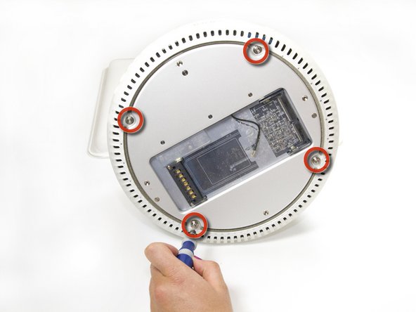

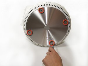

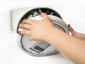

    • Place the computer monitor face down on a safe, harmless surface.
    • Using a Phillips #00 screw driver, remove the four 6.86 mm screws from the metal plate.

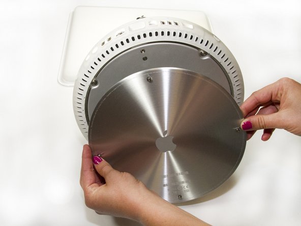

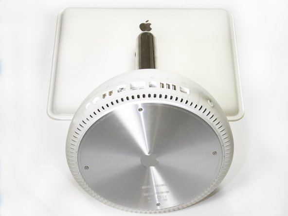

  2. iMac G4 15" 700 MHz EMC 1873 PRAM Battery Replacement: step 2, image 1 of 1
    • Remove the metal plate from bottom of the iMac G4.
    • The four screws do not completely separate from the metal plate.

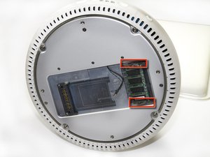

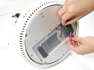

  3. iMac G4 15" 700 MHz EMC 1873 PRAM Battery Replacement, RAM DIMM: step 3, image 1 of 2 iMac G4 15" 700 MHz EMC 1873 PRAM Battery Replacement, RAM DIMM: step 3, image 2 of 2
    • Release the tabs on each side of the module by simultaneously pushing each tab away from the RAM.
    • These tabs lock the module in place and releasing them will cause the module to "pop" up.
    • Remove the RAM module from the iMac.

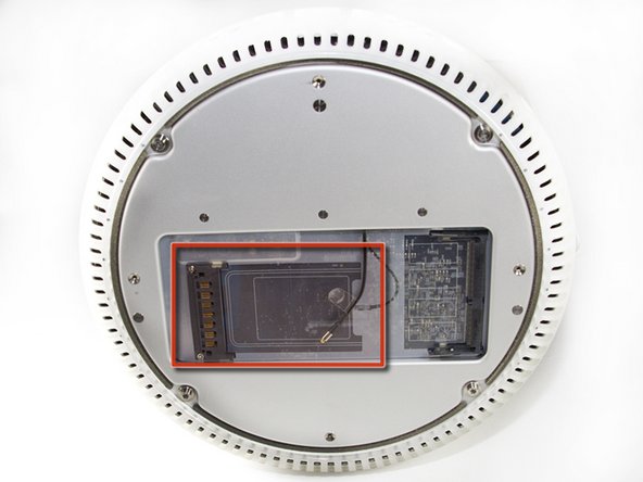

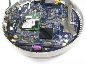

  4. iMac G4 15" 700 MHz EMC 1873 PRAM Battery Replacement, AirPort Card: step 4, image 1 of 1
    • Use a spudger to lift and remove the AirPort's antenna connector.
    • This step is only applicable to iMacs that came with an AirPort card installed.
  5. iMac G4 15" 700 MHz EMC 1873 PRAM Battery Replacement, Removing the Lower Case: step 5, image 1 of 1
    • Remove the four 28.07mm Torx #15 screws from the lower case.

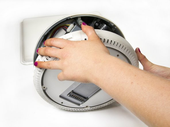

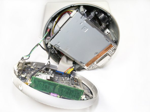

  6. iMac G4 15" 700 MHz EMC 1873 PRAM Battery Replacement: step 6, image 1 of 2 iMac G4 15" 700 MHz EMC 1873 PRAM Battery Replacement: step 6, image 2 of 2
    • Open the base by carefully pulling straight off, do not rotate the cover.
    • Open slowly to ensure that no cables are damaged or disconnected.

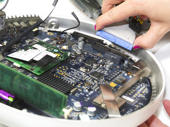

  8. iMac G4 15" 700 MHz EMC 1873 PRAM Battery Replacement: step 8, image 1 of 1
    • Grab both sides of the blue connector and firmly pull to remove it from the mother board.
    • Do not pull directly on the ribbon cable.
  9. iMac G4 15" 700 MHz EMC 1873 PRAM Battery Replacement, Internal RAM: step 9, image 1 of 1
    • Release the tabs on each side of the module by pulling them away from the internal RAM
    • Once the tabs are pulled the module will "pop" out and you can slowly remove it.

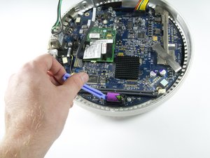

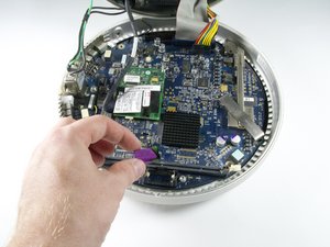

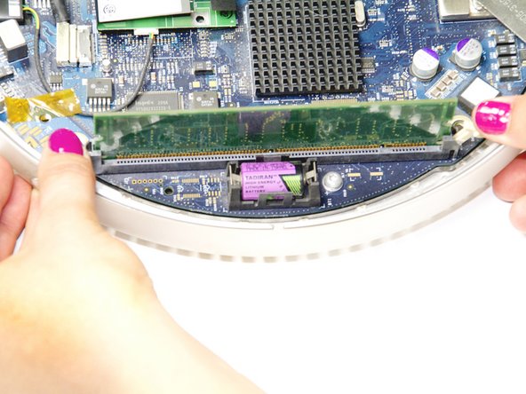

  10. iMac G4 15" 700 MHz EMC 1873 PRAM Battery Replacement, PRAM Battery: step 10, image 1 of 3 iMac G4 15" 700 MHz EMC 1873 PRAM Battery Replacement, PRAM Battery: step 10, image 2 of 3 iMac G4 15" 700 MHz EMC 1873 PRAM Battery Replacement, PRAM Battery: step 10, image 3 of 3
    • Use a spudger to gently pull the side of the battery out of the socket.
    • Remove the PRAM battery

To replace the PRAM battery you only need steps 1, 2, 5, 6 and 10. Or check out this guide instead, which includes the thermal paste step: iMac G4 17 800 MHz EMC 1936 PRAM Battery Replacement

Can someone share the battery type. It looks like a 1/2 AA battery, but all of my reference material refers to an Apple part number without any cross-reference to standard battery types.
Can someone who has the ability to do so confirm that it is a 1/2 AA 3.6v Lithium cell? And if it's not, is it some other standard type?
