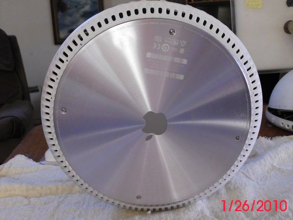

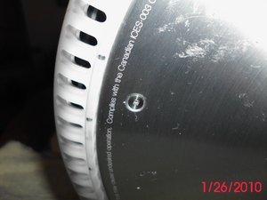

    • G4 bottom Plate with four captive Phillips screws
    • The bottom of the plate will list the serial number, MHz of the machine, standard RAM and hard drive size

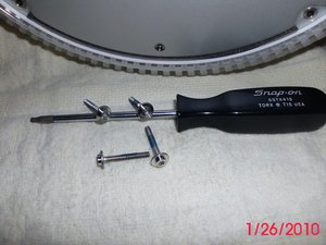

    • Remove the four T15 torx screws.

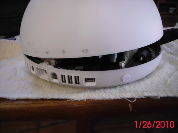

    • Set the unit on it's base, grasp the neck and tilt it to separate the base.

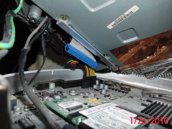

    • The IDE cable unplugs first.

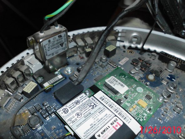

    • Locate the 3.6 volt 1/2 AA Lithium PRAM battery on the logic board and replace it.
