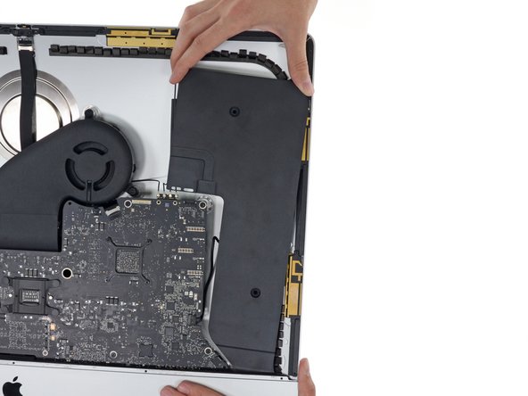

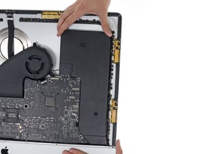

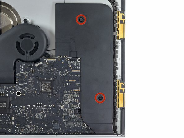

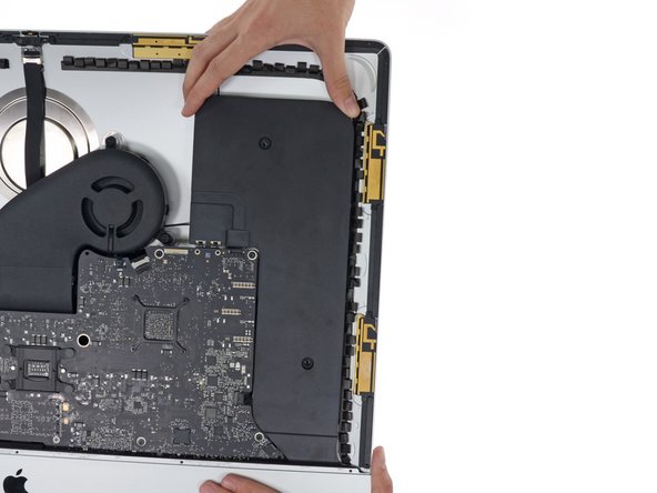

  25. iMac Intel 27" Retina 5k Display AirPort/Bluetooth Card Replacement, Right Speaker: step 25, image 1 of 1
    • Remove two 10.0 mm T10 screws.
  26. iMac Intel 27" Retina 5k Display AirPort/Bluetooth Card Replacement: step 26, image 1 of 2 iMac Intel 27" Retina 5k Display AirPort/Bluetooth Card Replacement: step 26, image 2 of 2
    • Gently rock the right speaker slightly to the right, to allow access to its cable's connection on the logic board.

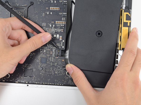

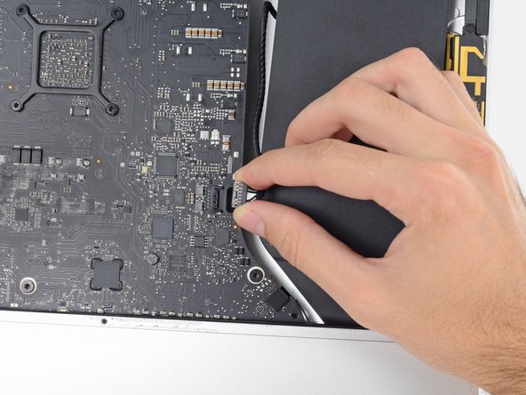

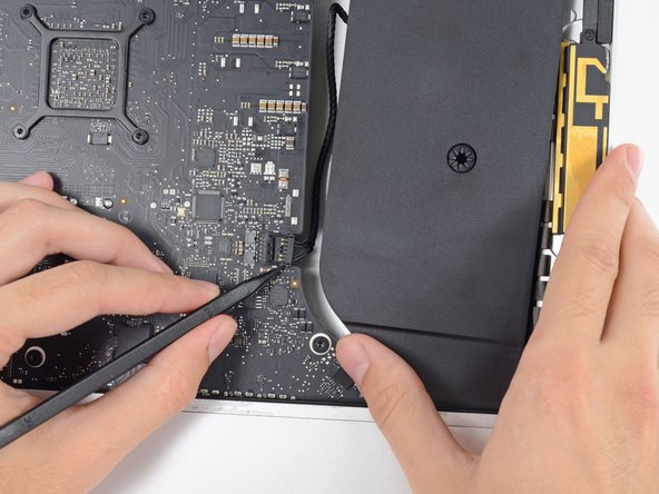

  27. iMac Intel 27" Retina 5k Display AirPort/Bluetooth Card Replacement: step 27, image 1 of 3 iMac Intel 27" Retina 5k Display AirPort/Bluetooth Card Replacement: step 27, image 2 of 3 iMac Intel 27" Retina 5k Display AirPort/Bluetooth Card Replacement: step 27, image 3 of 3
    • Use a spudger to loosen the right speaker cable's connector from its socket on the logic board.
    • Pull the connector to the right to remove it from its socket.

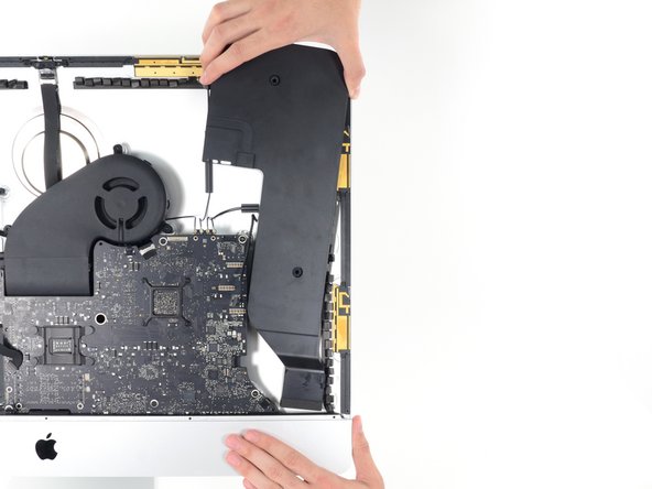

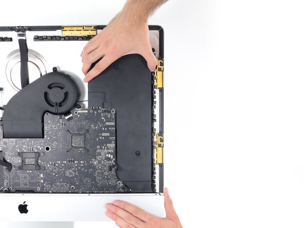

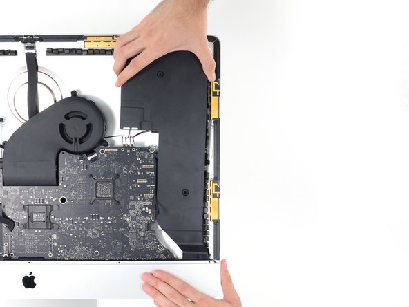

  28. iMac Intel 27" Retina 5k Display AirPort/Bluetooth Card Replacement: step 28, image 1 of 3 iMac Intel 27" Retina 5k Display AirPort/Bluetooth Card Replacement: step 28, image 2 of 3 iMac Intel 27" Retina 5k Display AirPort/Bluetooth Card Replacement: step 28, image 3 of 3
    • Lift the speaker straight up and remove it from the iMac.

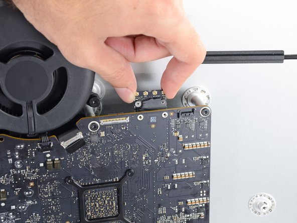

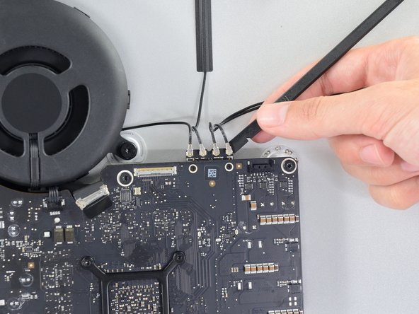

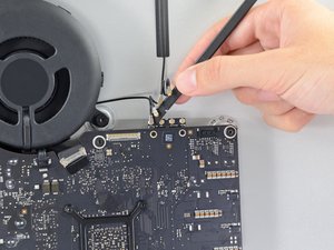

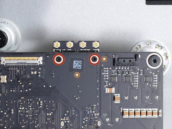

  29. iMac Intel 27" Retina 5k Display AirPort/Bluetooth Card Replacement, AirPort/Bluetooth Card: step 29, image 1 of 2 iMac Intel 27" Retina 5k Display AirPort/Bluetooth Card Replacement, AirPort/Bluetooth Card: step 29, image 2 of 2
    • Use the flat end of a spudger to disconnect each of the four antenna connectors from the AirPort/Bluetooth card.
    • Note the original positions for each connector when reconnecting the cables—from left to right on the card, the antennas are connected in the following order:
    • Leftmost
    • Top
    • Upper right
    • Lower right
  30. iMac Intel 27" Retina 5k Display AirPort/Bluetooth Card Replacement: step 30, image 1 of 1
    • Remove two 3.7 mm T5 screws securing the AirPort/Bluetooth card to the logic board.

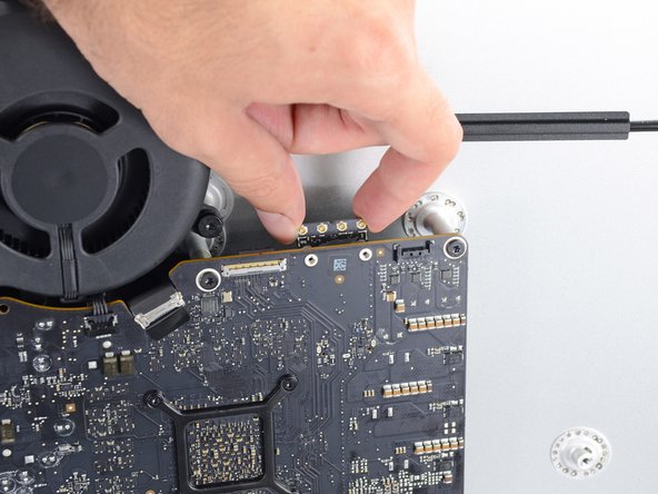

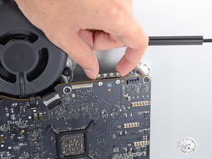

  31. iMac Intel 27" Retina 5k Display AirPort/Bluetooth Card Replacement: step 31, image 1 of 3 iMac Intel 27" Retina 5k Display AirPort/Bluetooth Card Replacement: step 31, image 2 of 3 iMac Intel 27" Retina 5k Display AirPort/Bluetooth Card Replacement: step 31, image 3 of 3
    • To avoid damaging its socket, do not push the end of the AirPort/Bluetooth Card away from the logic board excessively.
    • Push the end of the AirPort/Bluetooth Card slightly toward the rear case and pull it straight out of its socket on the logic board.
    • When reinstalling the card, be sure it is properly seated before reinstalling its retaining screw.
