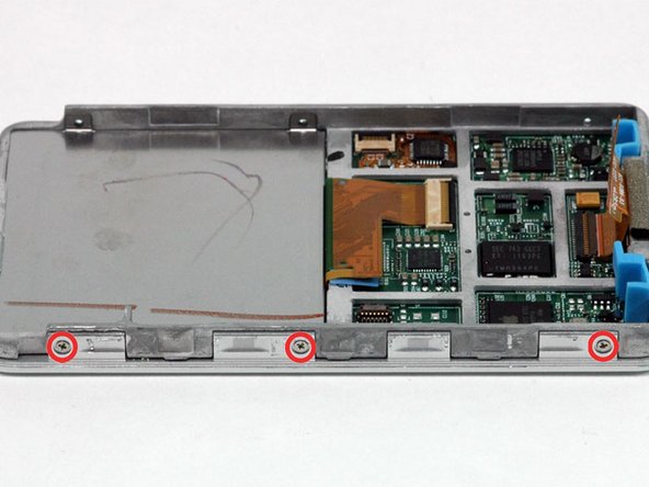

  26. iPod Classic Logic Board Replacement, Front Panel: step 26, image 1 of 1
    • Remove the three Phillips screws securing the front panel to the metal framework.

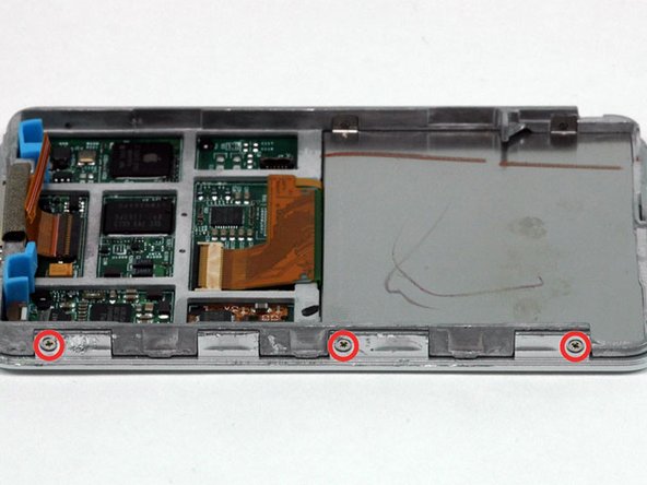

  27. iPod Classic Logic Board Replacement: step 27, image 1 of 1
    • Rotate the iPod 180 degrees and remove the three Phillips screws securing the front panel to the metal framework on the other side.
  28. iPod Classic Logic Board Replacement: step 28, image 1 of 1

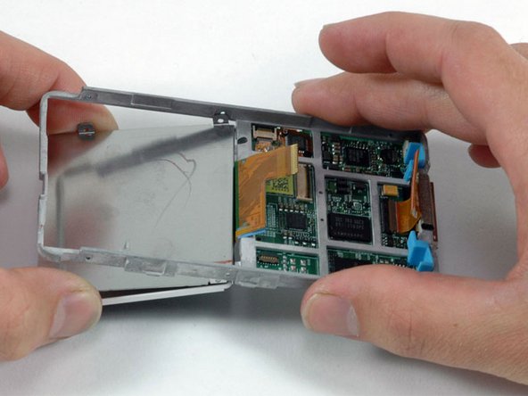

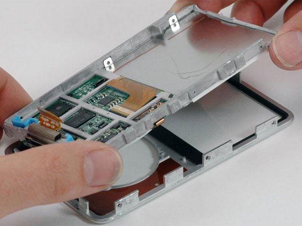

  29. iPod Classic Logic Board Replacement: step 29, image 1 of 1

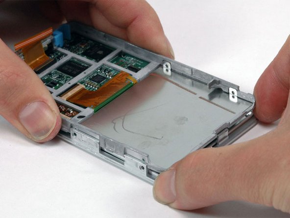

    • Lift the framework (including the attached screen, logic board, and click wheel) away from the front panel.
    • Make sure that the click wheel button is in place before reinstalling the framework in the front panel.
  30. iPod Classic Logic Board Replacement: step 30, image 1 of 1
    • The front panel is now free from the iPod.

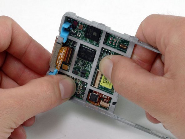

  34. iPod Classic Logic Board Replacement: step 34, image 1 of 1
    • Remove the two Phillips screws securing the logic board to the framework.
  35. iPod Classic Logic Board Replacement: step 35, image 1 of 1
    • Carefully push the logic board away from the metal framework.
    • The logic board is secured to the framework with mild adhesive. Be careful not to bend the logic board by pushing too much in any one spot.

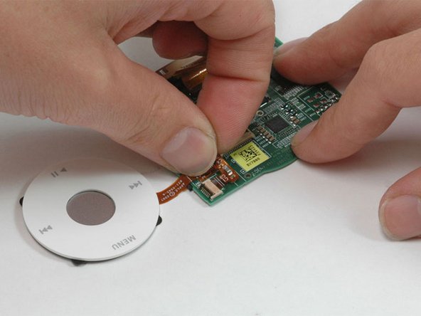

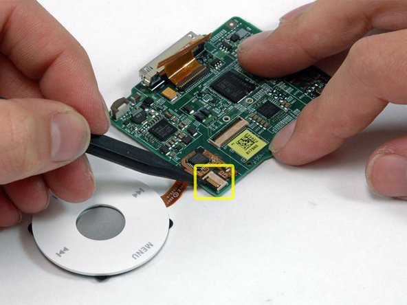

  36. iPod Classic Logic Board Replacement: step 36, image 1 of 1
    • Move the click wheel from beneath the logic board so that the icons on the click wheel are visible.
    • Use a spudger to flip up the plastic tab holding the orange click wheel ribbon in place. The tab will rotate up 90 degrees, releasing the ribbon cable.

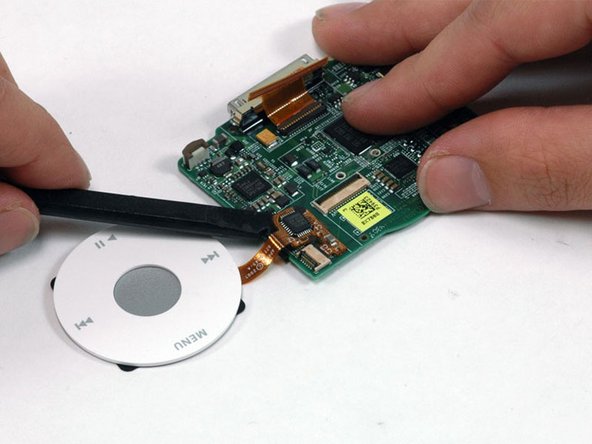

  37. iPod Classic Logic Board Replacement: step 37, image 1 of 1
    • Use a spudger to lift the click wheel cable off the logic board. Be careful not to bend the cable too much, or the electronics on the cable could be damaged.
    • When reinstalling the clickwheel, make sure that the click wheel cable is pushed all the way into its connector.
  38. iPod Classic Logic Board Replacement: step 38, image 1 of 1
    • Slide the click wheel cable out of its connector.
    • Lift the click wheel assembly away from the logic board.
    • Don't forget the click wheel button when putting your iPod back together.

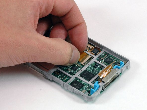

  39. iPod Classic Logic Board Replacement: step 39, image 1 of 1
    • Use a spudger to flip up the plastic tab holding the orange hard drive ribbon in place. The tab will rotate up 90 degrees, releasing the ribbon cable.
  40. iPod Classic Logic Board Replacement: step 40, image 1 of 1
    • Slide the orange hard drive ribbon cable directly out of its connector. The cable may be attached to the logic board with some adhesive. If the cable doesn't immediately come free, carefully pull up on the cable to loosen the adhesive.
  41. iPod Classic Logic Board Replacement: step 41, image 1 of 1
    • Logic board remains.
