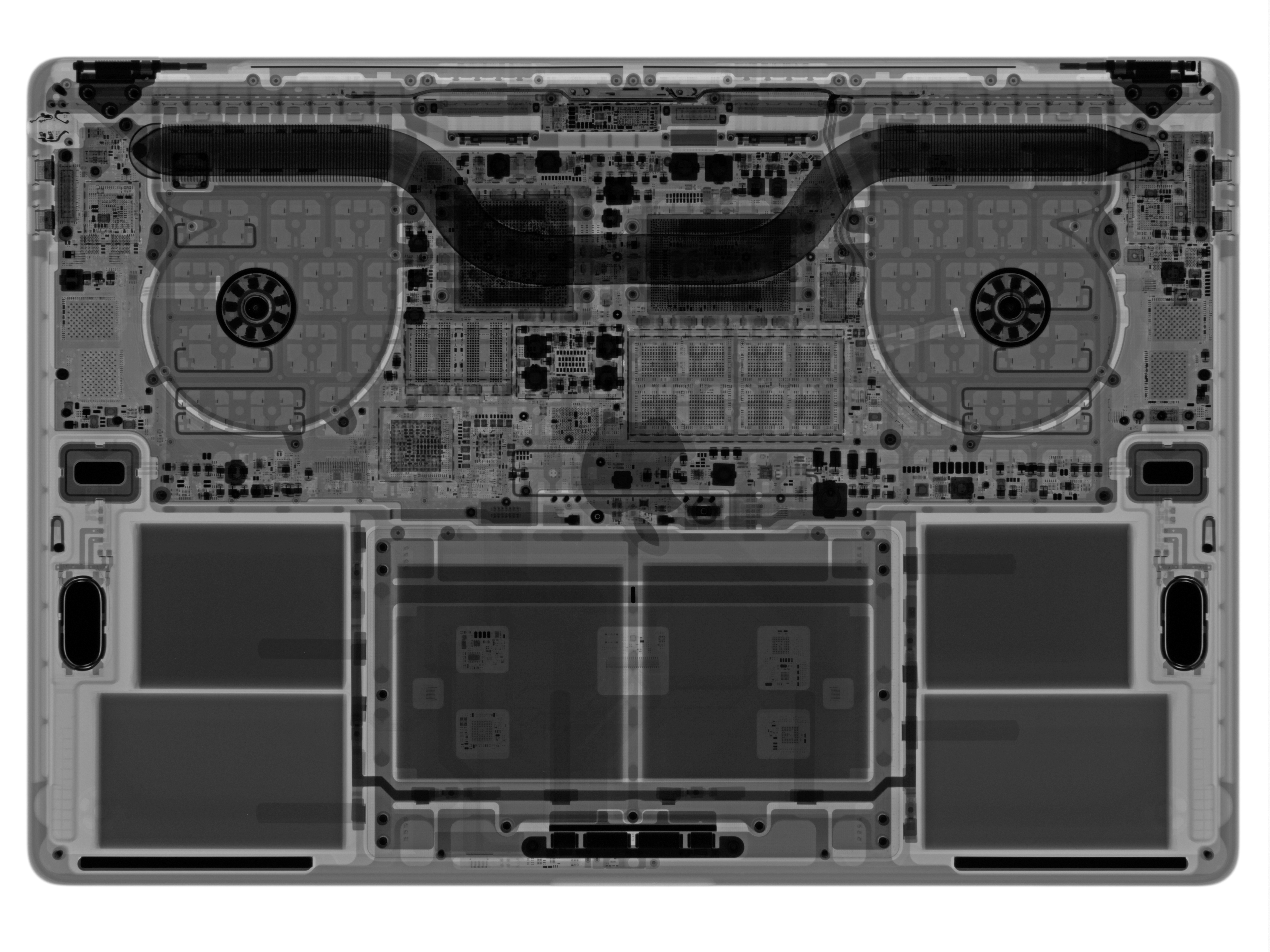

Teardown Update: Our friends at Creative Electron got their hands on a MacBook Air as well and put it through their signature X-ray treatment!
![](https://valkyrie.cdn.ifixit.com/media/2020/04/03142318/A2179_pic3-1-scaled.jpg)
A few cool things to zoom in on:
- Metal stabilizers underneath the wider keys (like the space bar) on the keyboard
- Tiny ribbon cable running up behind the display to connect the FaceTime HD camera
- Magnets in the speakers, trackpad, and fan
- More magnets in in the lower case and above the display to keep the laptop shut
- Hinges! Neither hinge appears to be equipped with the new lid angle sensor we found in the 16″ MacBook Pro last year (see this X-ray for comparison), but it’s hard to be certain without a more thorough investigation. Stay tuned!
